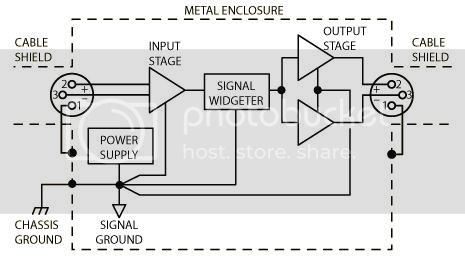

Here's a common arrangement. Note that the case is connected to the signal ground at only one point and the star arrangement of the signal ground ensures that no signal current flows through that connection. That's the ideal for balanced signals as in the figure. If the signals are unbalanced (the cable shields carrying signal current) then the situation is less ideal.
Joe
