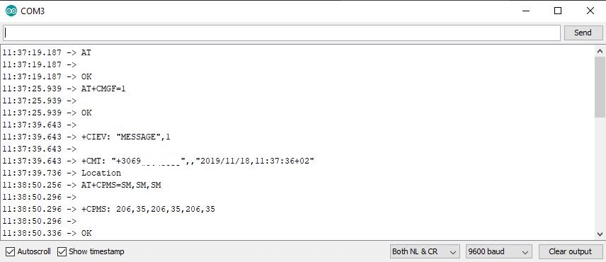

Hello I am trying to make a tracking device using a7 gsm gps gprs module and arduino uno R3.
I want my device to send me sms when it receives sms with the word "Location" but I can't make this happen...

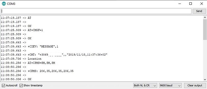

When i use serial monitor and communicate through AT command I see the new messages and i attached a photo of the serial monitor.
as a test i tried the receive sms example from gsm library but it doesnt work

this example stops at
if (gsmAccess.begin(PINNUMBER) == GSM_READY)
i disable the pin in this sim.
even if i delete this whole access with pin number procedure , it stacks at :
if (sms.available()) {
so the whole gsm library doesn't work with this module ?
I'm a noob but i tried a lot of different stuff and different codes but nothing could work.
I attached my exact gsm just to be sure.
maybe it is a module configuration problem and not the code it self ?
I really dont know
