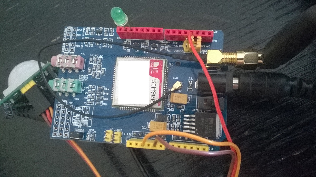

Hi Guys,
I placed/plugged the GSM shield onto the top of the Arduino as a common connection. Please see the image. And then I plug each DC adapters into them.
I think that there is enough current. Now I share with you the entire code. It has a part when calling is initiated. And dialing is working if the devices are feeded with power supply voltages. And I think that the calls have higher current demand than SMS sending/receiving. So that is why I still think it is not a power issue...
Sorry I did not share my whole code with you and I apologise as there could be unnecessary code lines. Just ignore them.
Any help is appreciated.

These kind of comncern me...
Multiple declarations of the same asset.
#include <SoftwareSerial.h>
#include "SIM900.h"
#include "sms.h"
SMSGSM sms;
SoftwareSerial SIM900(7, 8);
followed in setup() with
 SIM900.begin(9600);  // for GSM shield
  gsm.begin(9600);        // for GSM shield
Do you have TWO modem shields ?
One called sms(SIM900), and one called gsm ?
gsm appears to be using pins 1&2
sms appears to be using pins 7&8
Your libraries and function calls may be getting tangled up.
I didn't crawl through your code in detail, but I have written a lot of SMS/GSM and GPRS code - but I never had to use two separate libraries.
Perhaps you've fused two other blocks of code together to make your sketch... this isn't the way to do it.
I have only one GSM shield. Unfortunately I am not able to write such codes from scratch (yet :slight_smile: ) that is why I used libraries and code fragments. Anyway I'd like my project to work properly. That is why I turned to this forum to seek for help. I will correct those duplicated rows from the codes to see if it helps. The only problem is that calling works well but SMS receiving does not work well without Serial Connection to PC. This is very weird.

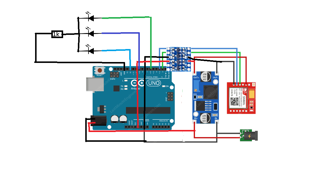

Hi guys, I'm taking this topic back to life. I am trying to do an Arduino relay control via SMS and I have a problem. So, if I connect the Arduino with the usb to my computer, open Serial Monitor and there it writes all his initialization process the whole device works perfectly. If I power down the circuit and then power it up without connecting the usb it does not respond to any command. I use a sim800l with my Arduino, it's powered up from the same power source with arduino but it has a step down module to 3.3V, I also used a logical level converter from 5v to 3.3v. So the Arduino , gsm shield and converter are al three powered up from the same power source (so common ground) this may not be a problem.
I attach my code so maybe somebody with more experience can tell me where I am wrong.
On short, I want my device to work properly by only powering it up and not needing to connect it to laptop's USB. Thank you!
PS. If I plug it to USB and it does his initialization and then I unplug the USB with the other power source still plugged in it still works :cold_sweat:

What’s your power supply arrangements?
The modem takes short bursts of up to 2A while registering and switching cells (or in low signal areas), which really needs to be considered.
An accurate schematic of your current setup will help.
This is my electrical scheme, I used 3 red LED s to simulate the relays. I looked on my power supply and it says it can feed up to 400mA :confused: I will try to put the arduino to my car's battery as I don t have another power source .
yeah, I think the max. 400mA PSU limit will cause problems - if not now, then certainly later.
And your separate regulator for the modem is a good idea.
I found a PC source and tried with it, it does exactly the same :frowning: . It also started to don't see the characters properly(when I sent On it recevied a square and 'n') but I modified the baud rate from 9600 to 19200 and it is ok now. Other ideas? I think something in the code may be wrong, like he does not respect de code if it doesen't see the initialization on the serial monitor of the laptop . I can hear the gsm module's little noise when it receives a SMS even if it's not connected to the pc.
Unfortunately I don’t have the same hardware, but as an engineer, I avoid software serial for the ‘workaround that it is’
I use 1280/2560/1284 chips and SIM 5320 and 7600 modems exclusively - also because my code tends to be a bit larger, and I use a fair bit of EEPROM and RAM.
Hardware serial just works, and doesn’t introduce ‘conditions’ you have to be aware of.
I’ve never seen the most common problems often posted in the forum. But in all computer projects, you can’t cut corners on the power supply planning.
...and in fact, I’ve cheated on cellular modem power supplies (in good signal areas), I use 1.2A on the 5V rail with no problems.
But that’s about as low as you can go with 470uF after the regulator.
I understand, but now I don t see any problem in my power supply planning, the new source cand provide 16A at 12V , far more than my setup needs. Maybe somebody else has been throw something similar cand can help me with an advice :smiley: thank you for your time @lastchancename !
ok, i’ll look a bit closer.
Hope i can help.
In your photo and drawing, you show two different modems, and in the drawing, what looks like a 3v3 level converter.
What’s the buck converter doing...
As a UNO plug-on shield, it’s probably 5v compatible, so the level conversion isn’t necessary (they’ll be onboard the modem shield). Check your docs.
Extra observations...
You should lose the String buffers, and explore c-strings to avoid memory problems in the future.
As mentioned previously, I prefer to use direct SMS reception, the buffer isn’t a problem, but gives you more work.
It’s certainly odd that it works with USB, but not without...
As far as I read some people recommend to use the logical converter because the sim800l runs on 3.3v(it's power voltage is between 3.3 and 4.3V). I will give it a try without the converter
Careful, check the datasheet for YOUR board, but as a plug-in UNO shield, it is most likely to be UNO 5v compatible.
