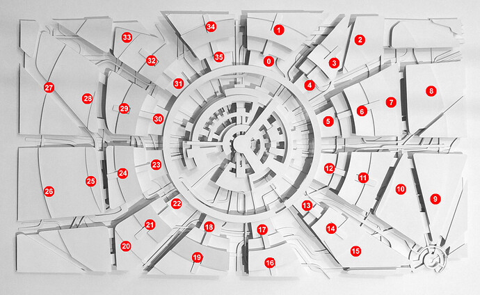

I'd like to create a radial matrix of 36 LEDs - attached a diagram. The ones I'm currently using have 3 diodes per module, so I guess that'd be 36 modules - attached a photo of that too. Each module pulls .72W (.24W per diode). I have a separate power supply for the LEDs if necessary. (That's a whole setup that confuses me - how I can control power via the Arduino, but it need not be coming from the board itself? I think my setup would require more power than the board could handle.)
I'm not sure what would be the best circuit design and offer me the most options for sequencing. Ideally I'm hoping to implement switches to allow for a few different sequences, pulsing, fading, following, etc...

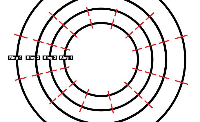

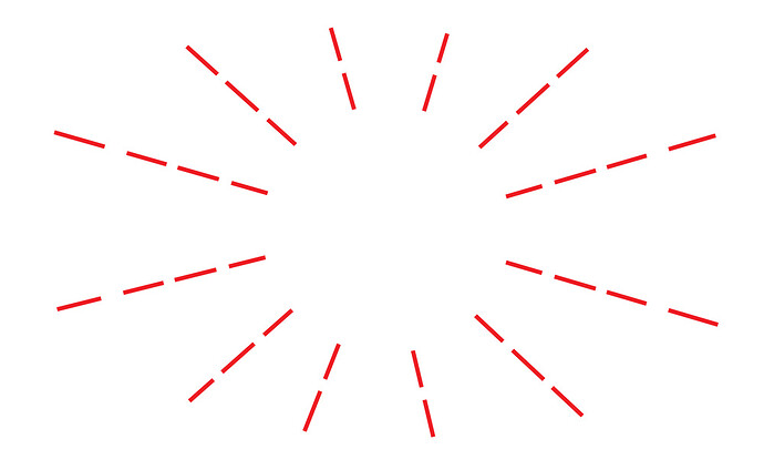

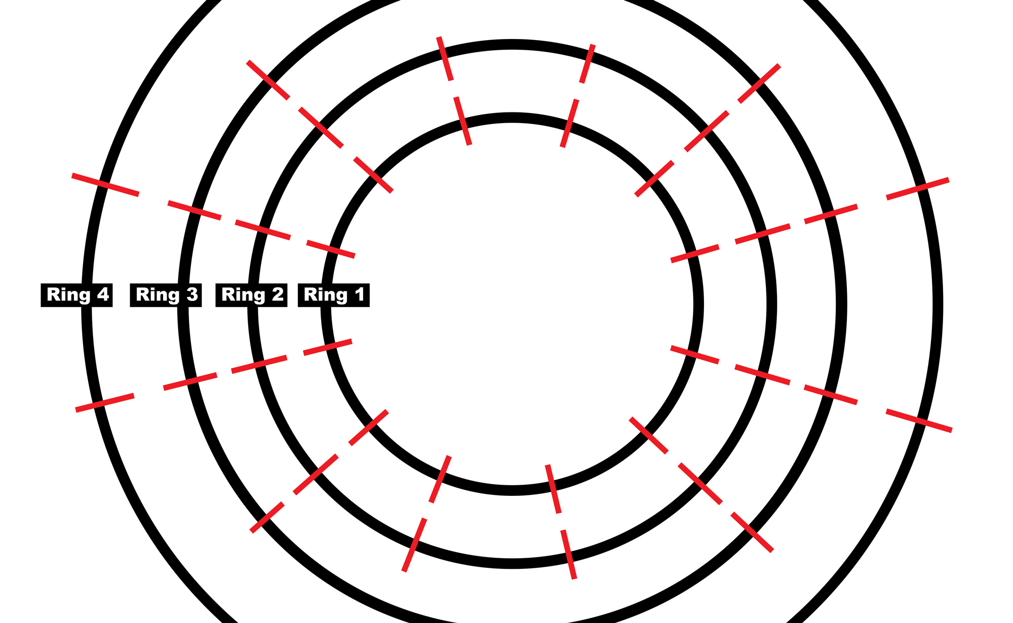

Considering I want to create radial patterns (light and fade concentric rings - image attached). Is there a smart way to organize this circuit that'll let me take advantage of the libraries/software that'll control WS2818 LEDs?
This post had some good advice about individually addressing each LED: Flying LED matrix - LEDs and Multiplexing - Arduino Forum
Not sure I can apply the spoke and ring code since I'd be using individual pixel LEDS vs the strips.

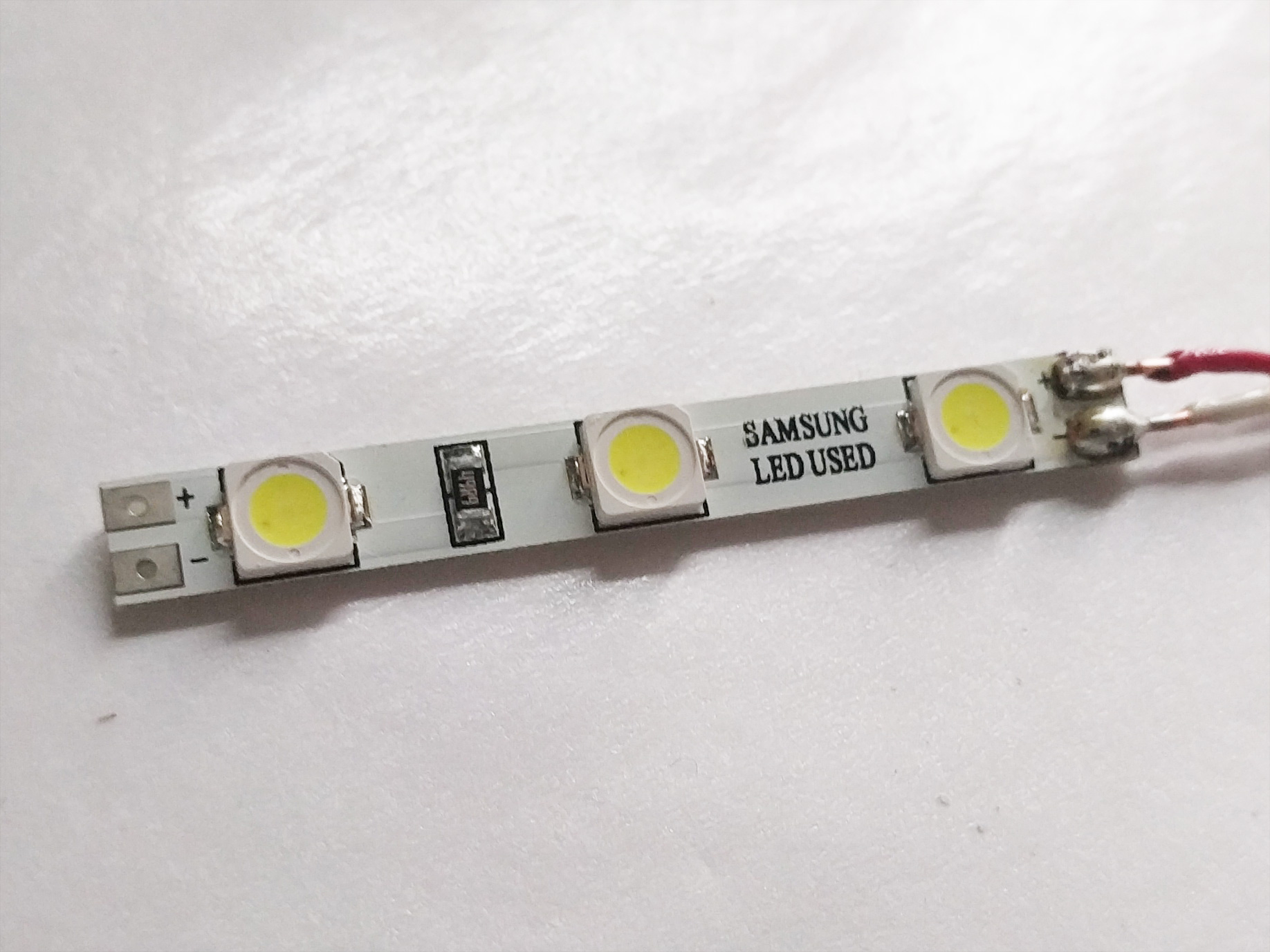

You can't address those LEDs individually, to do that you need the WS2812b LED strips sold as Neopixels.
I did something similar before Neopexiels were out, the PDF manual downloadable from the site tells you a lot more about the API that I built up to talk to an array in this manner.
http://www.thebox.myzen.co.uk/Hardware/Hexome.html
Thanks for that. Got it, I was confusing those with NeoPixel LEDs from Adafruit:
Breadboard-friendly RGB Smart NeoPixel - Sheet of 25 : ID 1558 : $39.95 : Adafruit Industries, Unique & fun DIY electronics and kits. I thought they were just a knockoff w/ the same chips, but I guess they just use the same LED. So many details...
I'm pretty sure the adafruit ones can be addressed individually and called out as a strip when connected.
Tho they recommend only 6" between them, which is a bummer. But it looks like I could snake it to 12" if I use heavier gauge wire: Neopixels - Any way to guarentee operation 12" apart? - adafruit industries

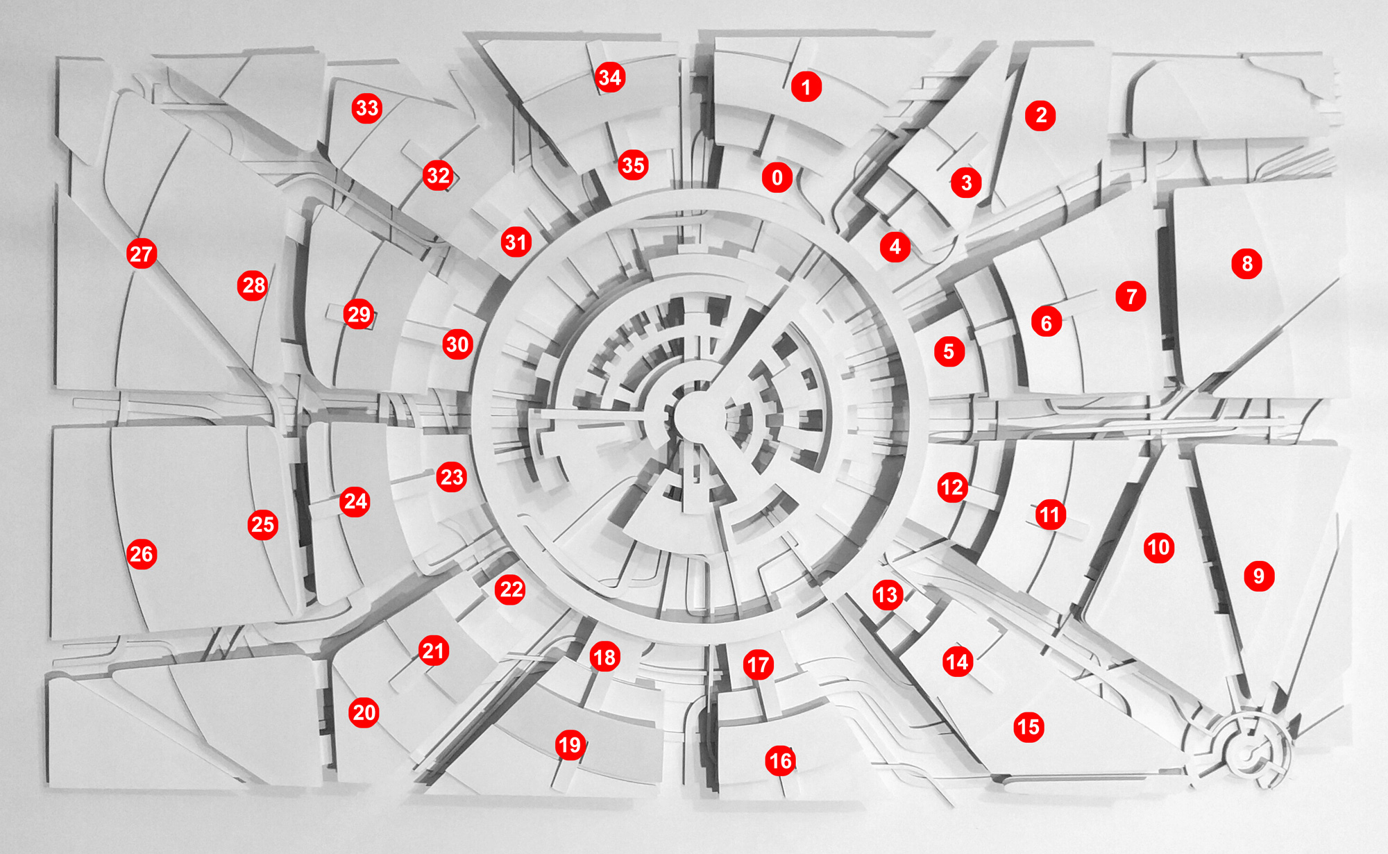

The design of this project prevents me from using an actual strip - I attached an image of it overlayed w/ a potential circuit. The LEDs will be mounted up, underneath the floating panels and some radii have gaps, so a strip wouldn't hide very well.
So if I continue in this fashion, am I in good shape?
Sounds like it.
