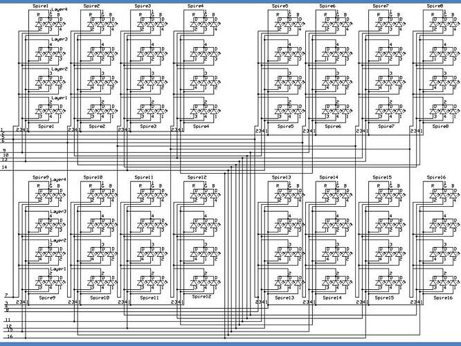

Hello. im new to this and decide to build a led cube according to this design Charliecube - Asher Glick
iv'e ordered al the parts i need but without realising ive ordered common annode rgb leds instead of common cathode rgbs!!!!!!
im sure theres a way i can alter the code to make it work but ive no idea how as im a complete noob..... :roll_eyes:
can someone please help as this is my first project and im panicking now...

What do you have for hardware?
With common anode, you'll need a PNP transistor to connect to the layers and individual current sinks for the columns.
Vs individual current sources for the columns and a NPN transistor or ULN2803 kind of part as a layer sink.
in the design: Charliecube - Asher Glick there are no resistors and the hardware is arduino nano 3.0.
ive been thinking about it and according to the way the spires are made it should still work but it will display backwards???? i think this is right but im not sure if i need to alter the pin settings so that it just works in reverse....
(note) i do not have any of the parts yet, not even an arduino. im using curcuit simulators and emulare until it comes but im trying to just get all the bits right... (ive built this damn thing about 100times in my head!!!...) im just doing the thinky bit now so ive got a head start... and im slightly obssesive... :astonished:
about the resitors, i was thinking about adding some just in case... just not sure where now...
i am very very green.... im looking to do a electronics course soon.... this is a step on hte ladder. i know a bit... but not much so go easy on me....
Hmm, that is clever. Would have to draw it out as a schematic to understand why no resistors are needed.
CrossRoads:

Got the schematic sussed out for common cathode.
If common anode, I don't know of just flipping the LEDs over will work, or if that will try & turn on too many LEDs at one time.
Need to work out the signal flows to understand turning on the LEDs still.

:slight_smile: :slight_smile: Aww dude. Thank you!! Like I said this is my first build and this is a learning aid more than anything. Once Ive got this built I'm gonna use it to learn about coding, so I'm quite excited about having to do a bit of work to make it operate properly. 8)
I kinda already thought what you suggested about Charlieplexing. I can think how it works and came to the same conclusion. I just wasn't sure.
I was "this" close to ordering some different leds...
Thank-you again. And thanks to bob too for the wicked schematic!! That's really useful...
