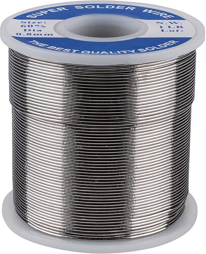

Also, i bought a weller pen solderer and .010 solder. Is that right? I dont want to spend a lot of money on a solderer, no more than $50 ideally if my weller wont work.

A 40 Watt iron is fine. However this iron looks quite cheap. Use the middle sized tip, make sure the screw is tight. Let it get hot before you start soldering. If the solder doesn't melt when the iron is up to temperature you may have a bad iron.
If the solder would not flow it sounds like you did not have the right sort. You need 40/60 lead tin solder with a rosen flux multi core. Do not use any plumbing flux as that is corrosive.

As for solder, again, don't cheap out. A good name brand 63/37 will have a better rosin. A pound will last you a really long time, why save $5 on poor solder?
