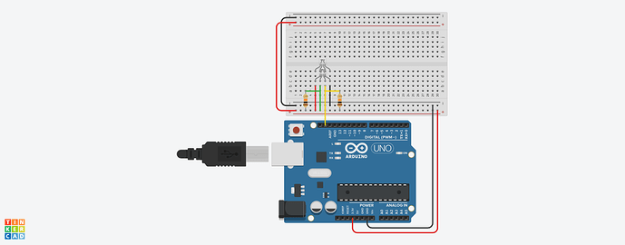

Thanks for the response. I never make schematics! Here is an attempt on tinkercad. I appologize for it not being correct, but I was not able to find the mkr board or any i2c sensors, so I used a 4 pin led in place of the i2c sensors. Hopefully it still makes sense what I did though.
That's your wiringand it could work if you connect the green wire to the SCL pin and not 5V.
But you should still post the schematics of the breakout board. There might be components that are important for getting the whole thing to work. You have pull-ups in the wiring diagram. If the breakout board already contains them you must not add them here additionally.
If you power the chip directly by 3.3V you may damage it. The same applies to the signal lines, pulling them to 3.3V may damage them (according to the datasheet).
