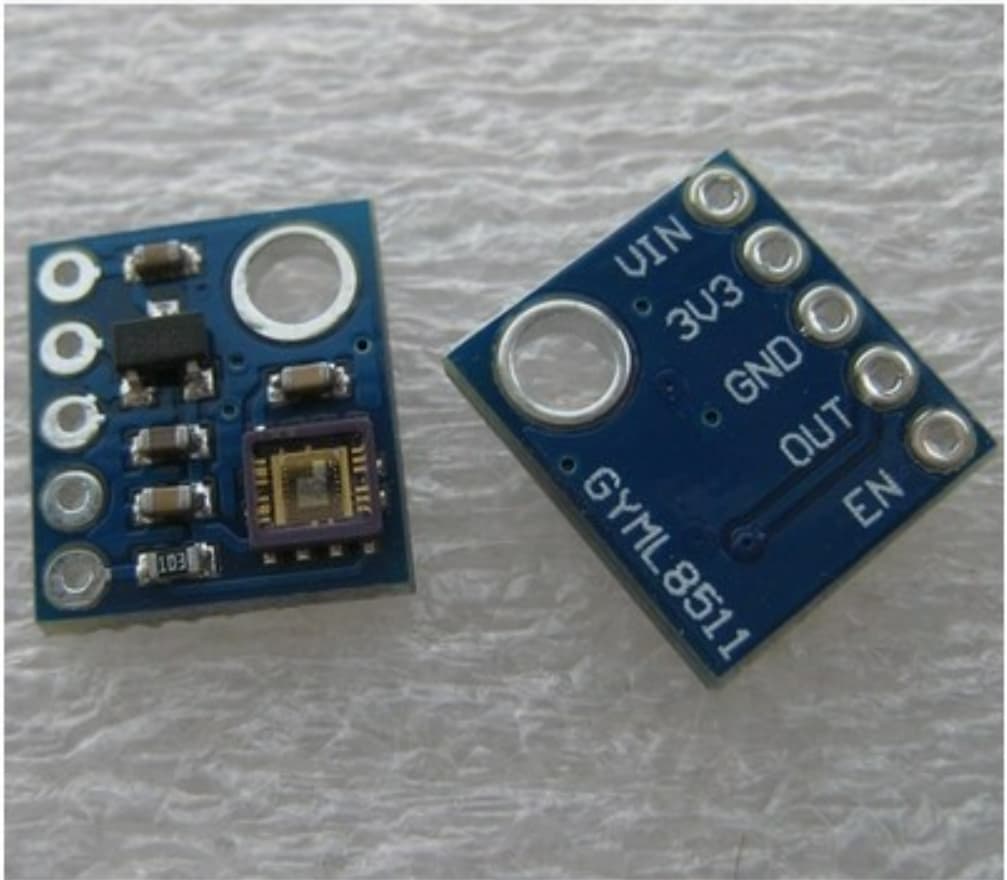

Hi! I'm part of a group doing a project for a physics lab class that's trying to use a GYML8511 UV Sensor with an Arduino Uno board to measure UV Intensity. We've found a sample hookup and code in various places, but our code consistently returns values way outside the parameters. None of us have any previous experience with Arduinos or C/C++, so we're really stumped. Additionally, all the sample hookups and other projects use a 4 pin ML8511 sensor versus our 5 pin GYML8511 sensor, though they seem to be just different models of the same thing and our hookup is the exact same.

And this is the sensor we're using:

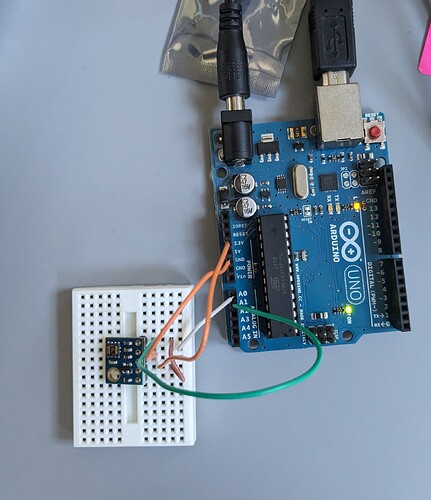

Here's how ours is hooked up:

Please post a link to the product page or user manual for your GYML8511 UV sensor.
The connections to the header pins on the module must be carefully and properly soldered. These are not and cannot be expected to work.
Adafruit and Sparkfun hobby suppliers have excellent guides to good soldering.
Capture
Thank you so much hahaha. It's working great now! Should've probably thought of that ourselves, but, all the same, much appreciated!
