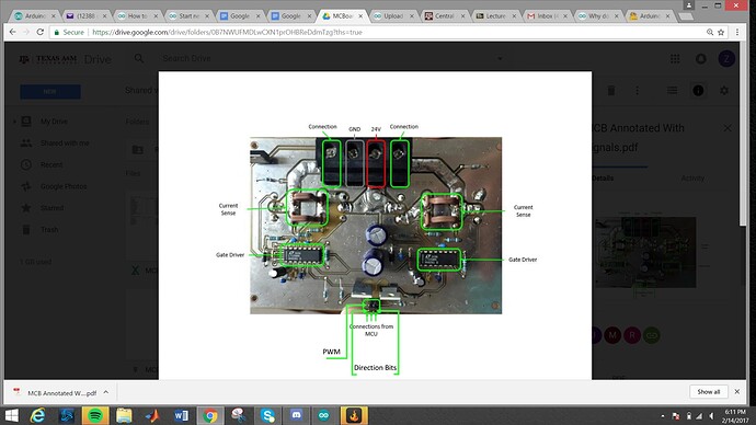

Good evening everyone, I am on an electrical engineering team here at Texas A&M and we are doing a project on a wheelchair for a quadriplegic man. We are currently debugging the motor controllers and have been slugging through the whole process. This project is a three year project and we received the motor controllers with a prevalent issue in regards to a current problem associated with a higher load such as when the user attempted to go up hills or a slight grade. Further debugging seemed to show that the motor controllers were functioning correctly and we started aiming at the processor, which is an ATmega2560. So in order to cross that off of the list. So I looked around the web and slightly copied the structure of someone elses code used on an Arduino Mega since its the same chip. The code is shown below.

So we have the directional bits that are either high or low in order to differentiate between forward and reverse and a PWM line going to the Motor Controllers. These digital output from the mega board are at 4.8V. The image of the Motor Controllers is attached. I have found that when connecting the PWM onto the header in attempts to have the signal go through the transistors gave no response from the motors. However if I placed the PWM signal directly to the input pin of the H-Bridge I can get a varying voltage on the motor terminals from 0-24V. It does fluxuate about 2v, which I feel may be alot, but this issue may be a real problem. Also the Left Motor Controller does not respond the same way the right one does. The right H-Bridge does not respond at all (so its only able to function in reverse) and the left H-Bridge, when attached to the pwm of the arduino it was stuck at 24v no matter the duty cycle of the PWM signal, so there is definitely something wrong there. If anyone has any insight to the reasoning behind this please feel free to ask questions and thank you for ya'll input.
I have trouble understand which parts of your setup you are refering to here. A diagram of the system making it crystal clear is needed - "the header" - what header? "the transistors" - what transistors, etc etc.

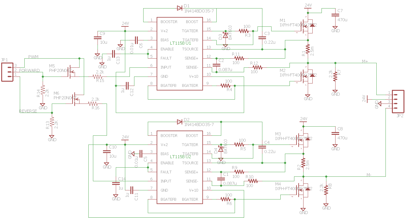

I have included all of the schematics for the boards along with some of the gerber files and .sch for you. If there is anything else that i can provide to assist ya'll I will happily include it in the post. Please feel free to ask for more information as this project is very complex and I completely understand if I am leaving important information out that may be keeping ya'll from being able to help. Thank you for ya'lls input!
Sorry about that it didn't upload.
That motor driver board looks like a complex way to reproduce what's inside a VNH2SP30 chip. You could replace the entire board with one chip and maybe one or two resistors and capacitors. I can't find a datasheet for your output transistors, so I can't find their current rating.
Looking at the inputs to the two half-drivers, what is the logic state of the input when the "direction" MOSFET (M5/M6) on that side is off? The block diagram of the LT1158 shows no pullup resistor on the input pin, so the state will be undefined. That could be the entire problem right there.

I asked for a diagram at the system level, not individual circuit board schematics, and an explanation I can follow for what
means in terms of the system components...
Which transistors?
Which header?
If you want help, answer the questions asked.
