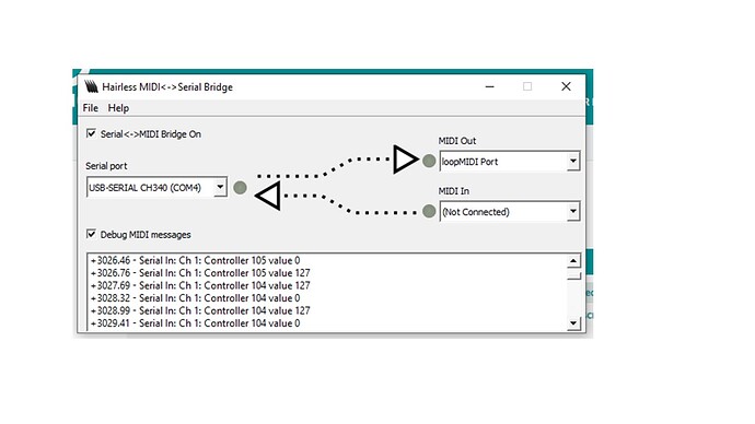

Hey, i just made a custom made loop station for my guitar, it works as a midi controller. The thing is that i have to press each button twice for it to send a signal, as shown in the attached picture. please give me a hand.

previous == stateButton;
Did you mean:
previous = stateButton;
This mistake is warned by the IDE. You should enable the warning setting to All.
