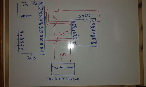

I'm trying to build a RPM counter using arduino, and to achieve that, I choose to use a simple hall effect sensor together with a small neodymium magnet stuck on a wheel attached to a DC motor.
I'm using the L293D IC to control the movement of my motors. I've tested the hall effect sensor and the L293D separatly and everything worked just fine. Problems began when I noticed that both the IC and the sensor required a 5v power supply from the arduino, and the sensor just doesn't work whenever the IC is also connected to the 5v power supply. I've read many times that this chip draws a lot of power, and I think that maybe that's the reason for the malfunctioning of the sensor. But what should I do? There's any way to get this sensor working again while the L293D is on?

Yeah, I know. I'm powering the motors with a 12V external power supply. I'm using the 5v on the arduino to power both the chip's logic and the hall effect sensor. Like I said, it works just fine if I'm powering just one of them, but the sensor starts giving wrong readings if I power both the chip's logic and the sensor with the 5v.
Here's a rough sketch of my circuit (sorry if it's confusing):

So you get wrong readings even without the motor connected?
Layout/wiring is also important.
Do you have decoupling on both VCC pins (see datasheet), and decoupling in the Hall sensor.

Yeah, that's right. If the chip's logic is powered on, I get wrong results.

No, I'm not using decoupling (I have to add some capacitors between Vcc and Gnd, right? What values should those capacitors be?).
0.1uF ceramic caps from ALL Vcc pins on all devices to Gnd.
