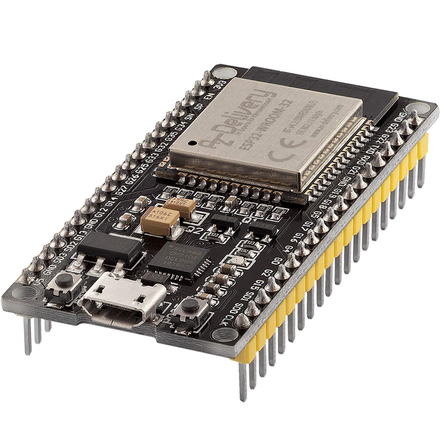

Hey Everyone,
I might be a bit out of my realm ( I'm an iOS programmer ) and a Halloween enthusiast. I was watching how to control props, someone used a RaspberryPi to activate a relay module into a cut up footpad and voila, it worked.
It just wasn't practical, so I started thinking: Can I buy a 1-Channel ( 5 or 12v?) Relay Module Switch, Hooked into a Arduino Nano, which this then plugs into the relay and the prop with this -\> [https://www.amazon.com/gp/product/B0D8LGBWX5/ref=ox\_sc\_act\_title\_1?smid=ABTEPSXTTA5JK&psc=1](https://www.amazon.com/gp/product/B0D8LGBWX5/ref=ox_sc_act_title_1?smid=ABTEPSXTTA5JK&psc=1).
Would that actually work? I would ideally run a webserver on the nano, which activated the module switches by a web request. Would also be able to hook in a sensor(s)?
Can this be a solution?

- You could use an ESP32 with some external hardware.
 ![image](https://europe1.discourse-cdn.com/arduino/original/4X/0/f/7/0f7ca5b063d3010a7880b9ff97f0f161dc3c467e.jpeg)
<div class="post-metadata">
**Author:** ![mkane](https://dub1.discourse-cdn.com/arduino/user_avatar/forum.arduino.cc/mkane/32/277702_2.png) [@mkane](https://forum.arduino.cc/u/mkane)\
**Post date:** [September 25, 2024, 2:31am UTC](https://forum.arduino.cc/t/halloween-prop-controller/1304851/5 "2024-09-25T02:31:02Z")
</div>
This is EXACTLY it! I will start researching along with this what I should buy!

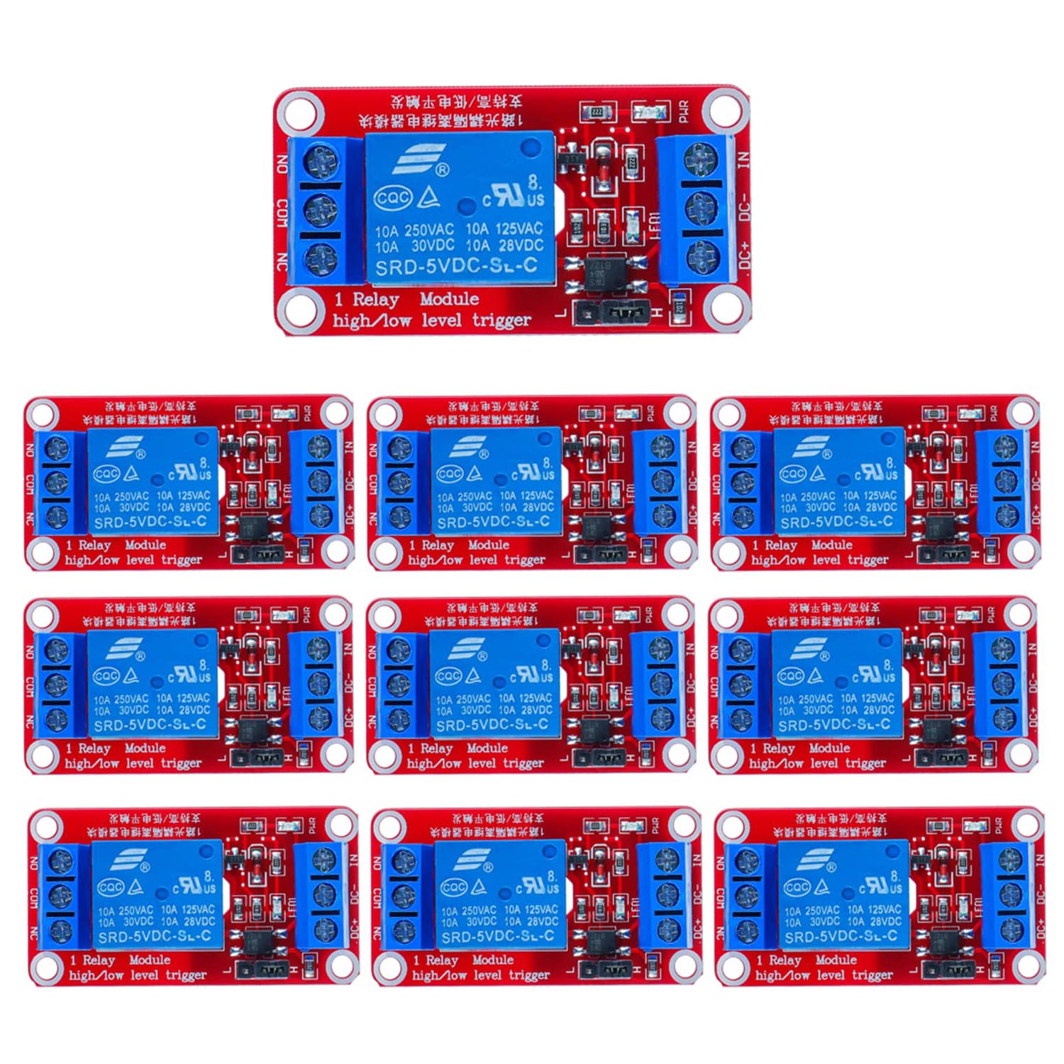

- First off, we have no idea what your skill sets are.
- You need to spend design time to come up with all the things that the project is to do.
- Relays come as modules and bare bones.
- To go from the 3v3 ESP32 to 5v logic, BJTs or logic level MOSFETs are required.

Can anyone help with my shopping cart list? My goal is to have this esp connect to an animated prop via foot pedal 3.5mm jack. I want to use an app ( I can make that ) to hit a web request & || use bluetooth ( both? ) to set it off. This is a POC but if possible id like to hook a battery pack to it and have a weather proof enclosure created.
Ardunio esp32 ( do i want headers? )
Will these work for foot pedals? [https://www.amazon.com/gp/product/B0D8LGBWX5/ref=ox\_sc\_act\_title\_2?smid=ABTEPSXTTA5JK&psc=1](https://www.amazon.com/gp/product/B0D8LGBWX5/ref=ox_sc_act_title_2?smid=ABTEPSXTTA5JK&psc=1)
Channel relay do I need 5 or 12v?
> **[HUAREW 5V One Channel Relay Module Relay Switch with OPTO Isolation High Low...](https://www.amazon.com/HUAREW-1-channle-optocoupler-Isolation-triggering/dp/B0B4W7SQXN)**
> Specifications: Material: PCB Control signal: TTL Trigger current: 5mA Operating voltage: 5V Maximum load: AC 250V/10A, DC 30V/10A Maximum Switching voltage: 250VAC, 30V Trigger voltage: 0-1.5V (LOW); 3-5V (HIGH) LED Indicators: Power Indicator:...
Battery?
> **[Amazon.com: LAMPVPATH (Pack of 4) AA Battery Holder Bundle Arduino Holder 2Pcs 2...](https://www.amazon.com/LAMPVPATH-Battery-Holder-Bundle-Arduino/dp/B07BNN9PDF)**
> Brand Name: LAMPVPATH Specification: --2 Types of AA Battery Holder for Arduino Holder: \<1\>2x 1.5V aa battery holder with wires \<2\>4x 1.5V 6 volt battery holder --Extra 2 Types of AA Battery Holder by DIY extension: Join one 2 X 1.5V aa battery...
Any specific solder? I have the soldering gun.
Thank you in advance.

> [@mkane](#):
I would think it's easier with an Uno R4 Wifi than an ESP32.
For one, the ESP32 isn't nearly as easy to work with, at least it hasn't been for me. That was the ESP32 Dev Kit with protoboard.
I'm not saying I don't like it, just that as someone used to working with Arduino as in Uno R3 and other AVR boards, the ESP32 wasn't as user friendly.
Plus, Uno R4 Wifi is 5V logic, ready to go with 5V relay module marketed to Arduino community.
You can use a shield and tons of modules designed around the Uno footprint and capability, plus tons on online support. I found the ESP32 less so in that regard as well.
Also library support for Uno is I think much more extensive than ESP32 or at least you have to look around (Servo for example).

These? [https://a.co/d/3okR9ZP1](https://a.co/d/3okR9ZP1)
For my first prototype this could work, my main concern was cost. The esp32 you can have 3 -5 for that price.
Any thoughts on the other items? Is that all I would need? Do I need resistors?
