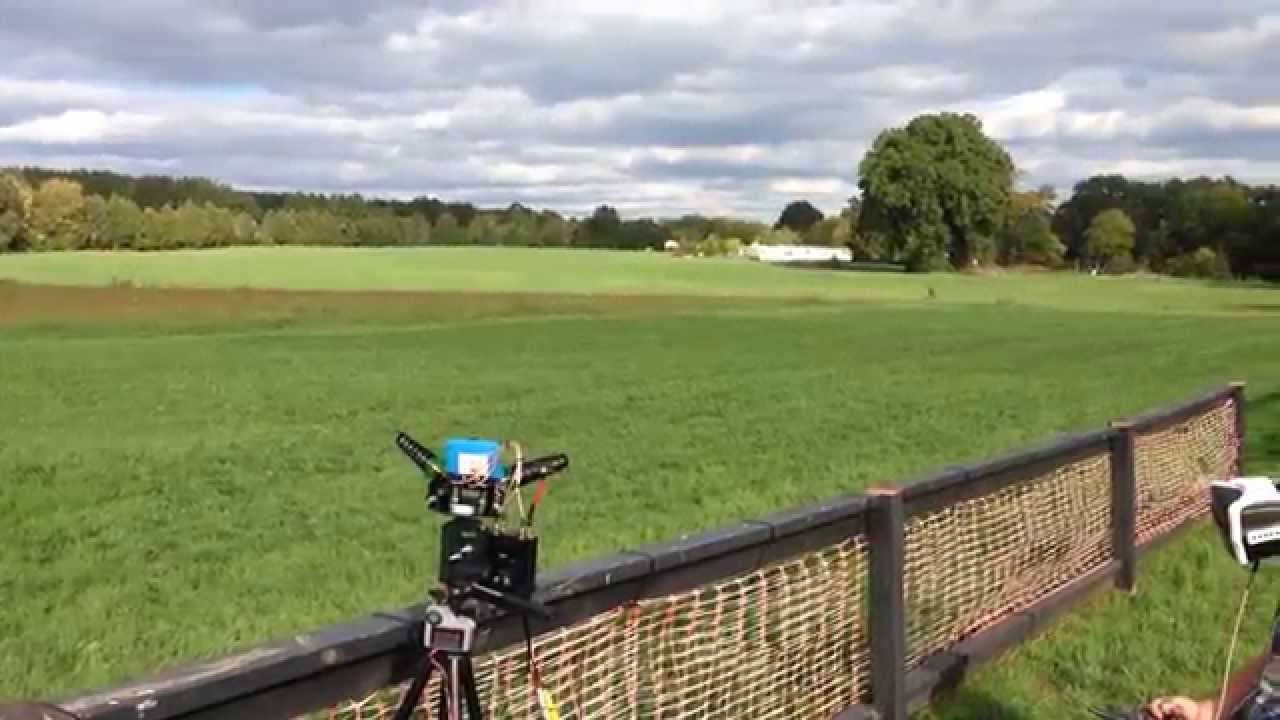

The sensors i'm reading are just two 0-1v outputs from recievers. They sink to a 100k resistor to ground with the attiny reading just before the resistor. Measureing at the ATtiny I see between 300mv and 800mv on either input. The servo signal wire is attached directly to the Attiny. I've tried other servos to see if that was the problem. no dice. The whole thing is powered by a 5v 5amp UBEC BEC (basically switching regulator). Output on the BEC measures about 5.25v
Here is a video of MY UNO version working quite flawlessly with the stock arduino servo library. You can see the idea. Reads two antennas, see which is hotter, steers servo to point reciever in that direction.

nosredna000:
Simple Arduino powered antenna tracker. - YouTube
I'm not interesting in watching videos.
And you were misleading. You said "This code works fantastically on my UNO".
If you used a different library, it's not the same code.
