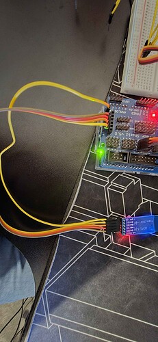

Hi, I am trying to setup 1 too 1 connection with my HC 05. so first of all I had to set up one as slave and the other as master and that worked perfectly fine. I did this using the same arduino.
Now I tried connecting each HC 05 to a Arduino so I have 2 Adruinos connected to my PC with HC 05 at each one. Then using the serial monitor I tried to send text like 'hello'
nothing came out on the serial monitor for the other arduino. I then disconnected to recheck my settings using AT commands and now I am not even getting a response when in the AT command mode for either of my HC 05s Not even 'OK' when inputting AT
I don't know what have done wrong and I am hoping I didn't brick them. I am a beginner so this my first time dealing with Bluetooth modules. (the lights are flashing so that's good sign at least)
Also the boards I am using are an ELEGOO UNO R3 with a sensor shield (I used this to alter the properties of the HC 05 in the AT command window) and an Arduino R4 Wifi.
one thing I did notice that was weird is when I connected the slave HC 05 the lights were not flashing at the exact same time as the Master HC 05. I am pretty sure I did connect them

Could you please provide a wiring diagram for the HC-05 and Arduino boards? It is unclear to me how you are using the R3s and the R4 WiFi in relation to one another. Perhaps you could provide some more detail.
Just to be clear, the HC-05 utilizes classic Bluetooth, while the UNO R4 WiFi does not support classic Bluetooth, only BLE.
In addition, could you please provide the Arduino code within code tags so that we can easily read the code?

Ok!
I am using 2 separate boards, I did all the setting up on the R3 (the blue board on top is a servo shield)
 ![image](https://europe1.discourse-cdn.com/arduino/original/4X/5/c/3/5c35237d6f494ac086801ee8341556b8fc54855b.jpeg)
 ![image](https://europe1.discourse-cdn.com/arduino/original/4X/9/5/0/9508399e0ce117830ae3548b30e981d86c74c4e3.png)
(It seems live ive connected them upside down but I havent, its just upsidedown)
also for the 'arduino code' I never used any. I put them into the serial monitor directly

Can you get an HC-05 into AT mode (slow blinking of its LED)?
If yes, and you type AT into the Arduino Serial Monitor and hit send, do you see anything?
If no, set the serial monitor to a slow baud rate and try again. Do you see anything? If it is unreadable, you must match the speed between the monitor and the HC-05. The default baud rate is 38400.
Perhaps you modified that to something else while you were experimenting.
Also, the HC-05 is a 3.3v part. This is described in the [Article](https://lastminuteengineers.com/hc05-at-commands-tutorial/).
Here is the quote:
> The Rx pin on the HC-05 module is not 5V tolerant. So, if you are using a 5V microcontroller such as Arduino UNO, you need to step down the Tx signal from the Arduino to 3.3V using a resistor divider. A 1K resistor between HC-05’s Rx and Arduino’s D0, and a 2K resistor between HC-05’s Rx and GND, will work just fine.

It sounds like somehow you bricked the boards. If you did not use a voltage divider, that might be the cause.

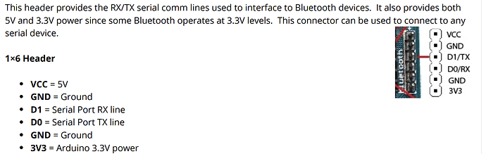

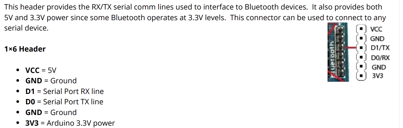

Also does that mean the vvideo I have sent is wrong?????? because I tried that then it worked (at the beginning ) and they did not use a voltage divider or any other external part
<div class="post-metadata">
**Author:** ![hash\_m](https://dub1.discourse-cdn.com/arduino/user_avatar/forum.arduino.cc/hash_m/32/1111844_2.png) [@hash\_m](https://forum.arduino.cc/u/hash_m)\
**Post date:** [January 19, 2025, 9:13pm UTC](https://forum.arduino.cc/t/having-trouble-with-at-commands-using-hc-05/1344508/14 "2025-01-19T21:13:29Z")
</div>
![image](https://europe1.discourse-cdn.com/arduino/original/4X/0/9/4/094b93b03756f467b95c9305f63f0699c424e898.png)
This is the specs of the bluetooth bit of the Sensor Shield is this bad news??

I am unfamiliar with the Sensor Shield, but it should be fine if it does the voltage conversion.
You only need to set the speed on the serial monitor. An empty sketch should be fine.
If you connected things with the power enabled or somehow misconnected things, that might destroy the HC-05.
