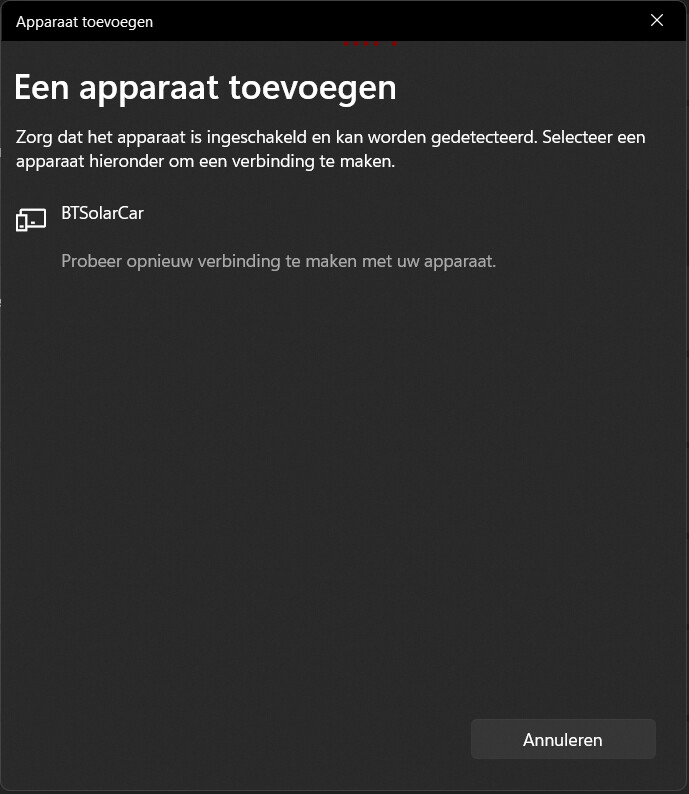

Update:
I figured out that I have a specific version of the HM10 with different commands (the mlt-bt05).
Now I can succesfully talk to it using the AT commands. One problem remains though, I'm not able to connect to it using my laptop bluetooth. I assured the password is '123456' via AT commands, but when I try to connect, I get this: (I'm sorry it's in dutch, I translated the text below the images.)
Translation:
Add a device
Make sure the device is activated and can be detected. Select a device from below to make a connection.
BTSolarCar
Establishing connection
Enter pincode for BTSolarCar
Translation:
Add a device
BTSolarCar
Try again to connect with your device.
This is amazingly annoying, because it is the very last step to get it working, the code on my laptop is already written and tested.
The device is in slave mode, the pincode is checked via serial commands and the internet doesn't seem to have a concrete answer.
During the first photo (Takes about 30sec), the indicator LED is burning continuously, indicating a connection. After this however (2nd photo), the LED somethimes starts blinking again, meaning it is waiting for connection. My pc never gives any indication of a succesfull connection, not in the BT settings nor in the device manager.
Any ideas?
Thanks in advance
HC-05 is a common SPP bluetooth module. HM-10 is a BLE (Bluetooth Low Energy) module. The two technologies are different form each other. Are you taking this into account?
The AT command should work with the MLT-BT05
mlt
although it isn't clear that you actually need it. Your laptop problem rather suggests that it isn't BLE compatible, so you might check that.
