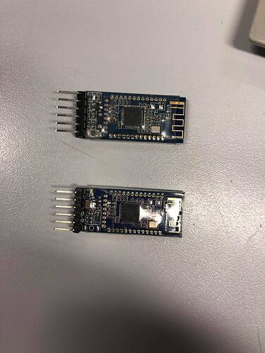

I have a HC-05 bluetooth module and also a zs-040 bluetooth module, but I cannot get it connected to my phone. I am trying to turn on something with arduino IDE and my smartphone with the S2 terminal app.
Does anyone have experience with this?
I have pictures of the modules I have in attachment.
Nice pictures but what about your code and a circuit diagram ?
