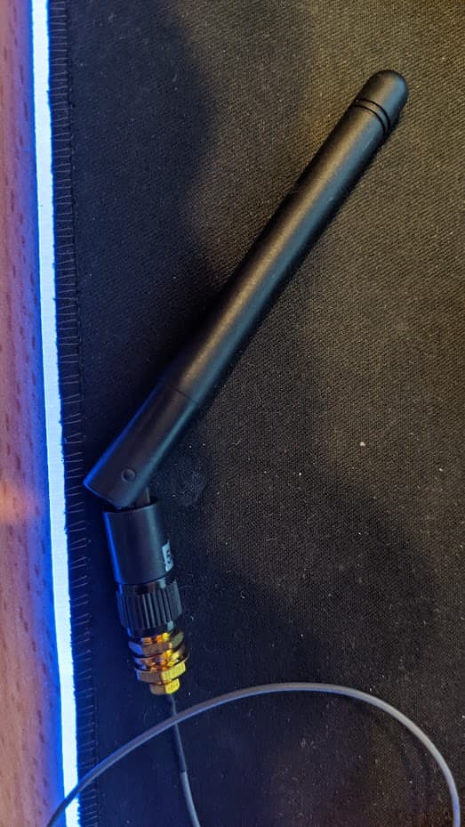

Please show a picture of your antennas. I have had very good results with my HC12's with a 17cm piece of straight wire. (1/4 wavelength 433 MHz).

While we are on this topic; I am using standard 2.4ghz antenna from my old wifi card and nrf24.
However I was wondering; is it correct to use these antennas or should I be using different ones?
Cheers
I would doubt it. The HC12's are 433MHz devices.
If you dont want to destroy your modules, use the correct antennas, i.e. ones designed for 433Mhz.
Is there much difference between using an external antenna or the spring antenna that comes with the HC12?
A 17 cm straight piece of wire is much better than either the spring, or the wrong (2.4 GHz) antenna.
