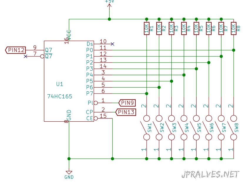

  • The schematic doesn’t seem to match the breadboard switch wiring.
  • Did that sketch produce that Serial output ?
  • Use a 100nF ceramic de-coupling capacitor.
  • Supply us with an all encompassing schematic.

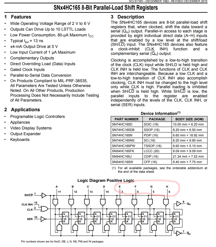

I can read the chip identifier: 74HC165. The HC in 74HC165 stands for High Speed CMOS.
Your assertion is not supported by reality.
Let's review.
Pins 3, 4, 5 and 6 on the 74HC165 IC are inputs.
Pins 3, 4, 5 and 6 on the 74HC165 IC are not connected to anything.
Therefore pins 3, 4, 5 and 6 are floating.
CMOS inputs should never be left floating. Doing so invites all manner of problems. As mentioned in the datasheet for the IC:
(1) All unused inputs of the device must be held at VCC or GND to ensure proper device operation. Refer to the TI application report, Implications of Slow or Floating CMOS Inputs, literature number SCBA004.

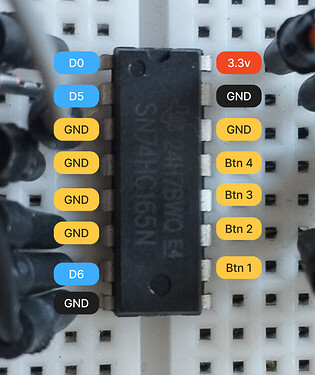

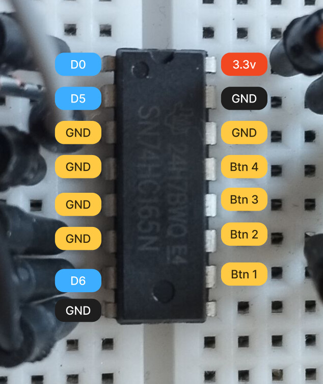

Everything is working right now! @Wawa , @van_der_decken and @LarryD Thank you so much :blue_heart:. For those who have faced the same problem (Connecting SN74HC165N with Esp8266):
  1. I cleared my breadboard from unnecessary components.
  2. Measured the resistance of each resistor, it should be 10k oms (everything was fine in my case).
  3. Reconnect shift register pins with microcontroller. Here is the schematics
  4. Powered Buttons and Shift register with 3.3v.
  5. Connected every unused pin at shift register to GND.
  6. Uploaded the code:
