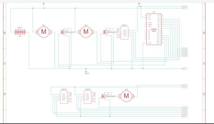

HCSRO4 problems
The "other one" works if you put delays between the pings... "mosfets" turn on over 200cm (pardon the pacmen 01042024)
Need to see a wiring diagram/schematic of how you have things connected.
I stopped using the newping code, cuz it was having a lot of problems, I added the delay but it was still messing up
They r connected to different pins here

What problem(s)? You did not try. I tried.
I did, the measurements get stuck on the same number very often, and the delay for the mosfet to go on is too big. This is code I used:

Your code uses pins 8,9,12 for the mosfets but you schematic shows 11,12,13
yh, I changed the pins in the real world version
So, if you disconnect the wires from pins 10, 11, ans 12, does the code work correctly?
yh on tinkercad
So you don't have a real circuit?
I do, but I can't use 10 and 11 cuz there r pins stuck in them
So does the real circuit work if you remove the wires from 8,9,12?
wdym?
If you disconnect the wires from pins 8, 9 and 12, and you run the code you posted, do the unltasonic sensors give you the correct readings?
Yh, I just tried, when I disconnected 8,9,12 the readings were consistently accurate
Are you really using 9V battery to power 3 pump DC motors? Do you have flyback diodes over pump motors? Any photo of what you`re actually doing?
OK, then the problem is with the way you have your motors and mosfets connected.
