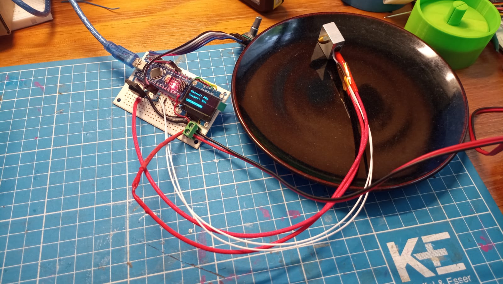

Hello.
I was able to put together the circuit heater controller from the following link:
and I have it running out of a 12V PC power supply.
I did the auto tune and the parameters I got are as follows:
#define KP 13.69
#define KI 0.12
#define KD 385.05
#define SMOOTHING_WINDOW 5
#define MOSFET_GATE_PIN 3
#define THERMISTOR_PIN A6
#define KY040_CLK 9
#define KY040_DT 8
#define KY040_SW 2
#define KY040_STEPS_PER_NOTCH 2
bool heaterOn = false, pOnM = false;
double pwmOut, curTemp, setTemp = 0;
NTC_Thermistor* thermistor = new NTC_Thermistor(THERMISTOR_PIN, 99800, 100000, 25, 3950);
I am using a larger resistor with the thermistor.
The circuit works well execpt that the heater continues heating even after it reaches the target temperature.
If I press the rotary button it stops and the temperature gows down, as expected. The LED turns on once the target temperature is reached, goes of once it is surpassed. So the program seems to be OK, but why doesn´t the heater stop heating after reaching the target?
If anyone has built this circuit and has any advise on what I should check, I would greatly appreciate it.
Thank you!

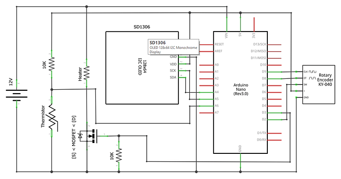

You should post your sketch and a circuit drawing for better help.
I suspect your code is blocking. We cannot determine that unless we can see it. Also an annotated schematic would help as well. Be sure to show all connections, power, ground, power sources and note any leads over 25cm/10".

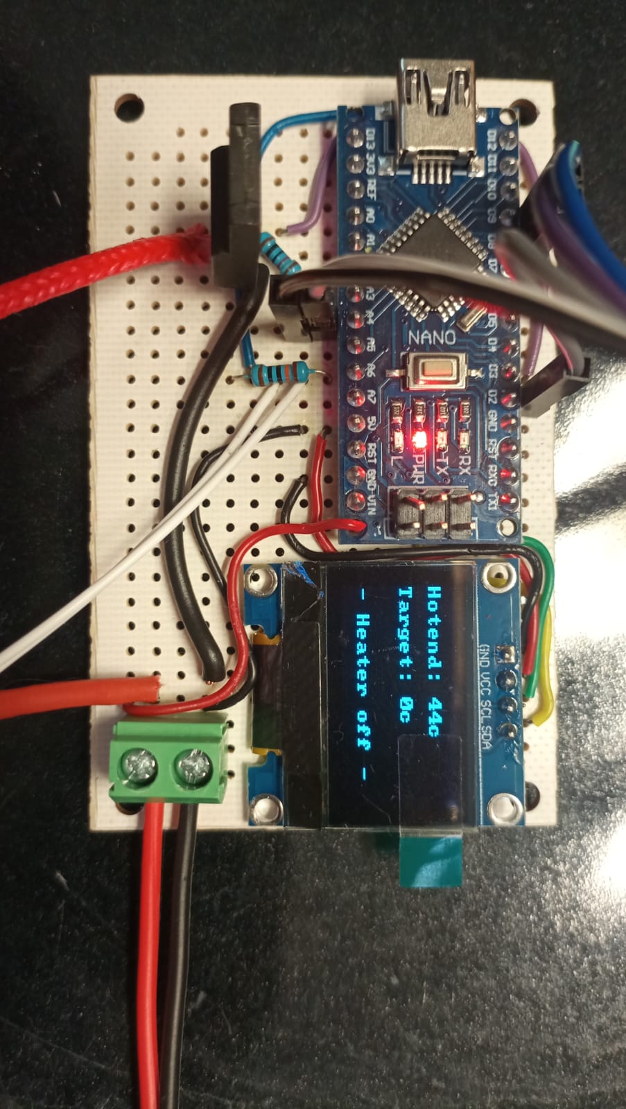

Here is a picture of the diagram and of the built circuit.
Below is the sketch.
When the heater is off as selected by the rotary switch, the voltage at the gate of the STP16NF06FP MOSFET is zero: When I setup a temperature the voltage changes from 0.2 to about 2.5V and fluctuates. But it seems to remain on even after reaching the target temperature, except if I turn it of by pressing the rotary switch again. Then it goes back to zero.

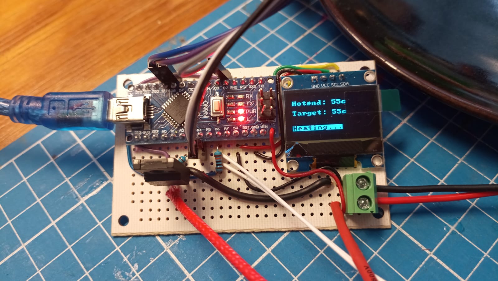

I re-ran the autotune program and adjusted the PID as follows:
KP 14.13
KI 0.09
KD 553.70
Upon reaching the target temp of 55 here is the serial monitor:
These pictures are from the whole circuit working properly at low temp (55 degC).
It is now slowly moving above 55 to 57C, but it takes much longer thant for higher temperatures.
What are the units on that data? Does pwmOut=0.69 mean 69% of a 20W(?) heater is needed to maintain 55°C
From the data you show it updates every 0.5 sec, and maybe you only read/take data to integer degrees and integer differences.
I don't know that I'd put much faith in the Autotune numbers.
