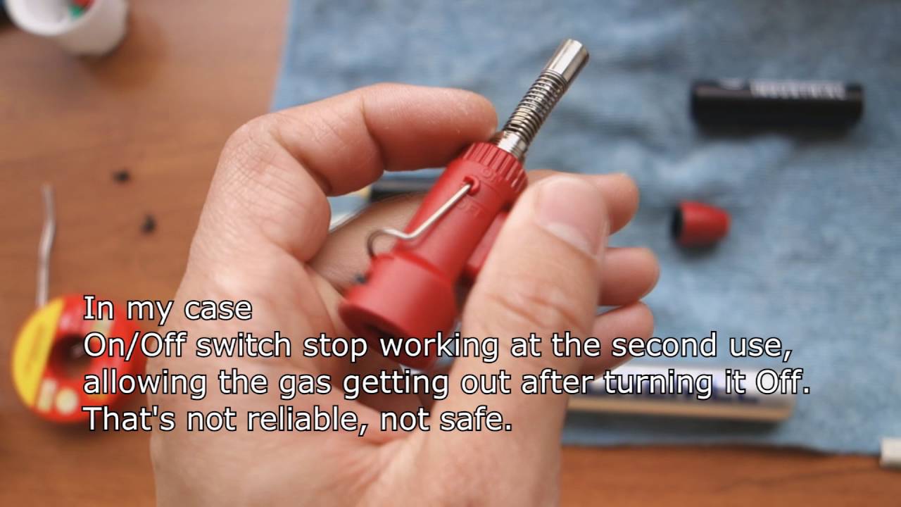

Quick question. Im trying to solder onto a tone pot on a guitar. The pot never gets hots enough so the solder melts onto to make a good connection. Im using a Rothenburger gas pen. The last thing I want to do is ruin the pot. The obvious question here is do I need a mains-powered soldering iron as the Rothenburg isn't hot enough?

A Rothenburger gas pen is not a suitable tool for electronics soldering as it is not temperature controlled. It is listed as 800 degrees C tip temperature which will simply burn the flux off before a joint will properly flow. Those temperatures can and will damage pots and other similar components.
An appropriate soldering iron and solder is a must for anything electronic.

The Rothenburger gas pen according to this:-
is rubbish for soldering and is not safe.
