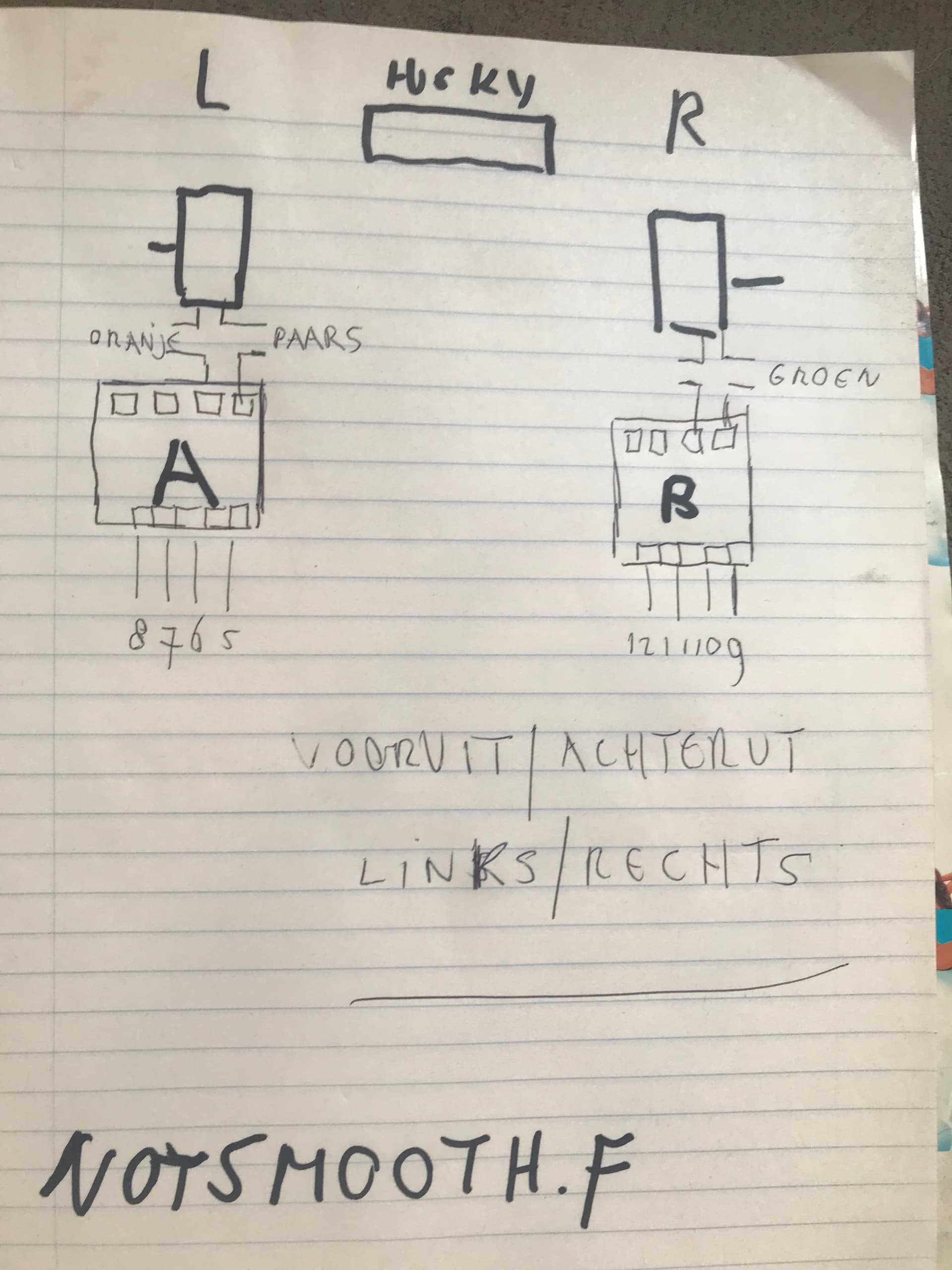

That's was a problem, but with testing I found the right connections to hook up the motors and controllers.
Here's a rough drawing of the set up.
Really? Yet you posted it as something useful. I would say ChatGPT IS a problem if it can't tell left from right.
Looks to me that you have problem with responding so agressively. Whats your problem? I'm not familiar with programming and via ChatGTP made a code that works. So what?

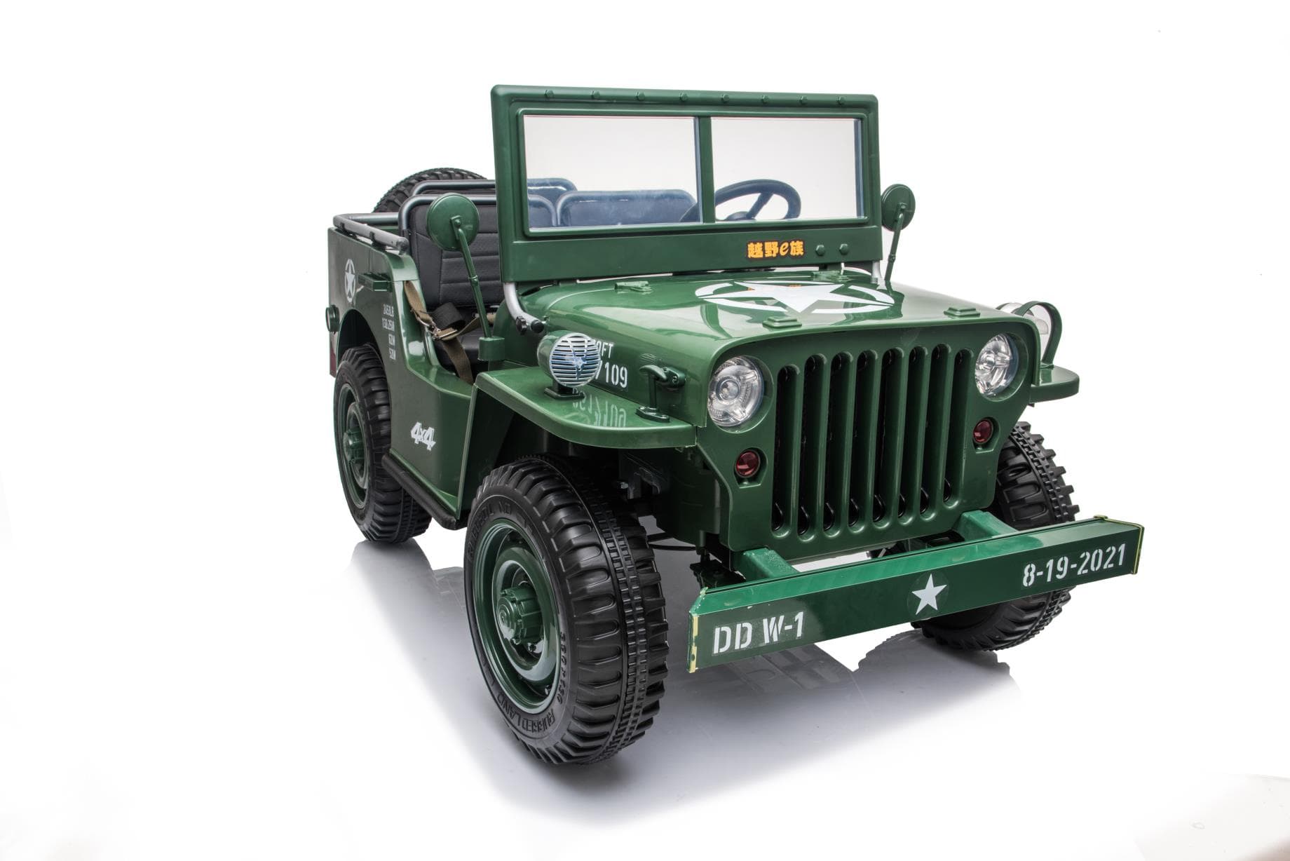

How heavy/large is this robot? Will you be sticking with one sensor? How are you overriding the robot control in an emergency?
What I want to do is build it into a kiddy car. I have a 4 wheel drive Willy's Jeep that
weighs about 40 kilo's.
The jeep is already radio controlled. Its a kiddy car. I intend to use it as a mule.
Oh cool, but that code won't work. Your code is for a differential steering type robot, like a tank or a skid steer.
That Jeep is Ackermann steering, like a car. Even if you lock the steering out, the turning as coded will try (and fail) to skate the wheels left and right.
Every wheel has his own motor, so I think it will act as a tank if I hook up two motors
on controller A and two on controller B. With turning A go's forward and B goes backward, pivotting. It does already with test runs on a model. If the object is centered the model will go straight forward or backwards if it is to close. The steering will be locked and the bumper will function like a emergency stop. Its goes slow, around 5mph but maybe I will adjust the speed because 40 kilo's wil probably hurt your legs.
You'll need to control each motor independently, like a skid steer. 4WD ride on toy, pretty sweet. Didn't realize it was 4WD. If your track width is wider than your wheelbase is long, should turn ok. You may still get skating but the plastic wheels should slip ok.
Interested to see it in action when you get it working as designed.
