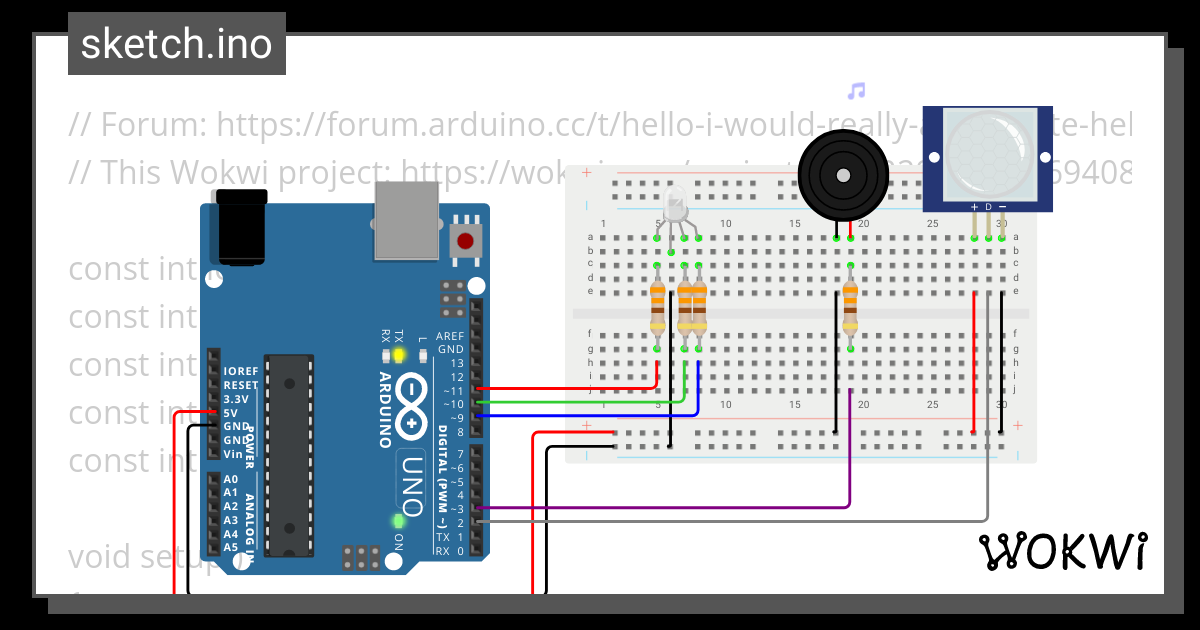

This Image is a representation of the circuit I am supposed to build for a project for school. However, I have little to no knowledge over how to use circuits, build them, etc. All I have so far is a code for the Arduino UNO that seems shaky at best (it works in the simulation, but I don't know if it also works IRL?) and I would really, really appreciate some help.
If anyone is knowledgeable in this field, please, do respond to this thread. The main things I'm confused about is what components would we actually need? I've made a basic list so far, yet there are topics such as capacitors etc. which just confuse me more. All I would need to know are what components I would need to fully make this a functioning circuit, as well as maybe some hints as to if my code would truly work IRL.

Reformatting your code (CTRL-T in the IDE) makes it easier to see structure:
int LEDR = 11;
int pir = 2;
int buzzer = 5;

The things that look weird to me is missing a Serial.begin(115200); in setup and the use of "r".
I'd use a Serial.print(val); instead of a println() to make the diagnosing less frantic, but if the pir is wired up right, you should see useful diagnostics on the serial monitor.
Looks like the teacher was so annoyed by a bunch of smombies that don't want to read any books that he resignated :ghost:
For the confusing "r" and the buzzer, maybe you should look into digitalWrite(), analogWrite(), and tone().
If you are confused, then you can test each part in the setup() function.
Let the led blink, make the buzzer buzz, and show something on the Serial Monitor.
Here is my own interpretation in the Wokwi simulator:

Here's documentation for the words in those lines:
https://docs.arduino.cc/programming/
And @Koepel's excellent advice to "test each part in the setup()" and his simulation in #16 show what they can do.
