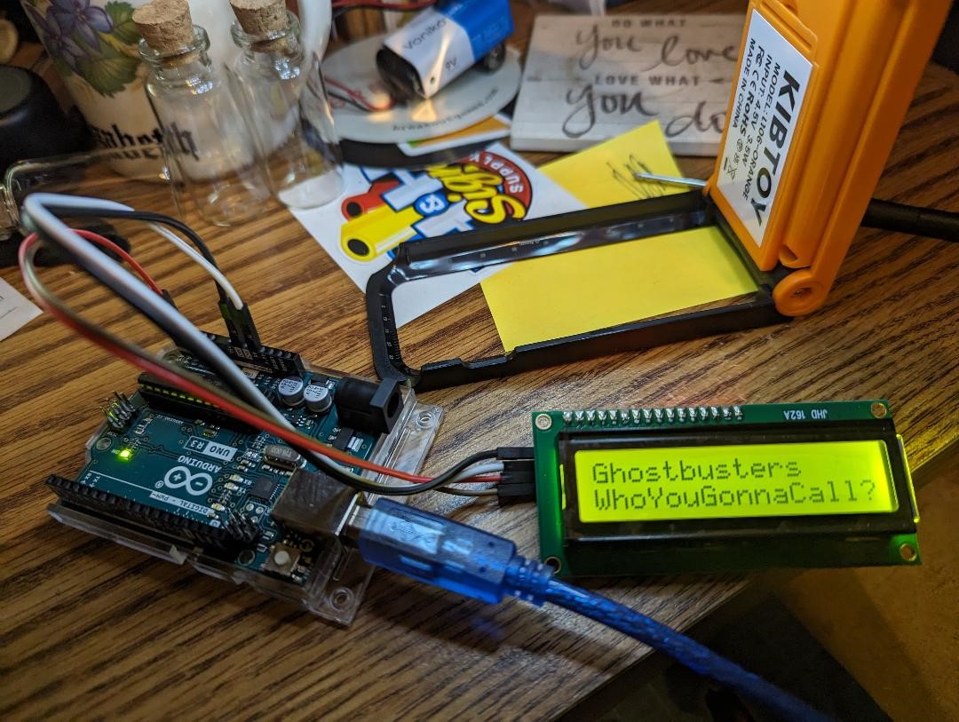

Thanks for that link. I did not try this with the breadboard first. The LCD was already soldered with the l2c, because quite frankly all the attempts I've tried at soldering have gone terrible. I use just about any power tool but haven't got the hang of that thing yet. I was trying to avoid it. But I'm starting to wonder if that is where the issue lies.
Try again with your shortest jumper wires on A5/A4 (power and ground can be any reasonable length). IIC (inter-integrated-circuit) is made for short runs on a circuit board. and post a picture of the (each?) LCD showing the results
He's got a backpack on it, the jumper to the ardu won't matter, I have run 6 feet of 20AWG on those.
Please show the code that you are using. This should be VERY simple,

Your solder job looks good so no issues there. Need to see your project code.
Also regarding wires, for an I2C LCD they CANNOT be loose AT ALL
don't say you meant this sketch while name this topic
So I took the various advice I was given and played around with different wiring and a sketch from another library I had installed and for some reason it worked. I changed the sketch a little because I didn't like the backlight flashing that was written into it and I have success. But now I want to know why this one worked so I can learn what I did wrong. What does everyone think?
