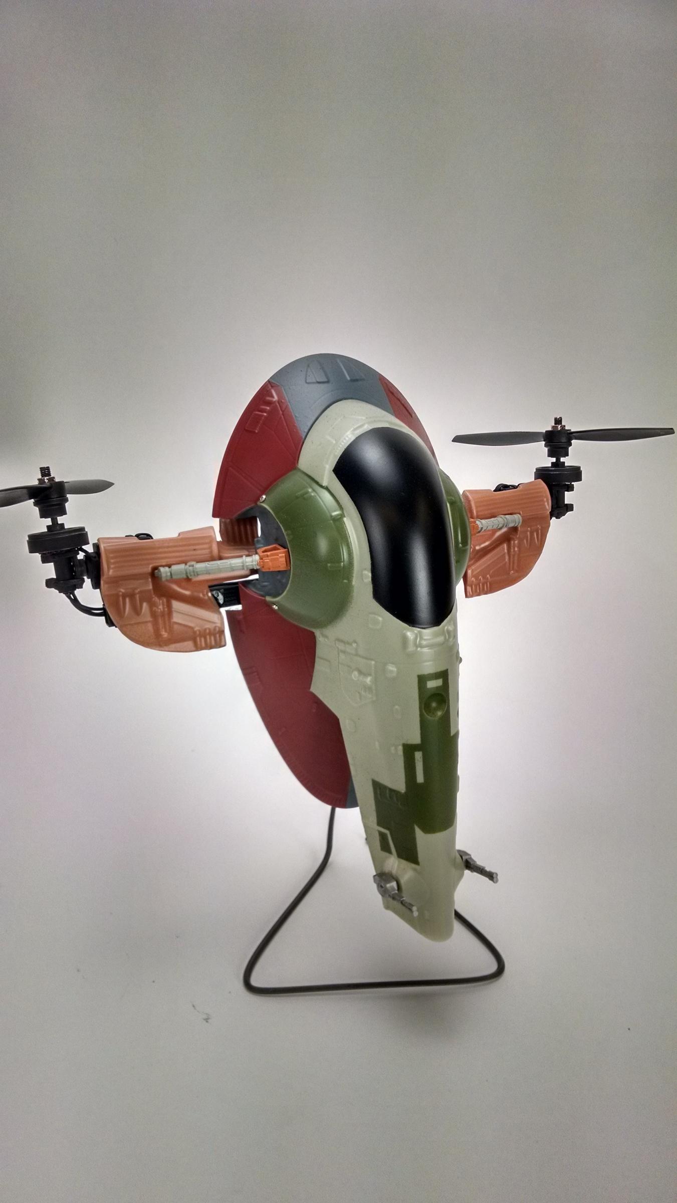

Sorry for the delay
Here you have some pictures
I hope you can help me
That is some cool designing!
There are 2 things that worry me.
  1. servo connection
    Directly connecting the servo to the motor mount does give a slop-free attachment. But there is a down side. You are wasting most of the servo throw. In normal stable flight, you will probably only be using a few degrees each direction. Let's say 10 degrees total. The other 170 degrees of travel go unused. The down side is that the servo sensitivity spread across all 180 degrees. By limiting eh travel of the servo to 10 degrees, you are giving up sensitivity.
    I suspect that your PID results will be much better if more of that servo sensitivity is utilized in the range of movement that your motor will actually move.
    Different mechanical connections will let the servo range of travel be closer to its maximum while keeping the motor movement in its expected range. This will give you the best sensitivity for best control.
  2. CG
    your center of gravity looks close to your center of lift. The only successful bicopter that I saw had the CG quite a bit further lower than the center of lift.

One update on my end. I am testing the stabilization algorithm with just one pid loop per axis using the angle as the imput
Thanks again!!!!!!

Hey I made some changes in my design having into account your suggestions and the changes are awesome.
I put the center of gravity a little bit lower
I attach some images
Thanks!!!!!!
