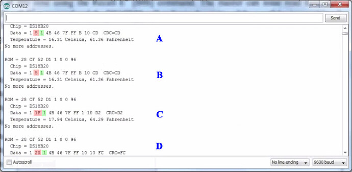

So, Group C, Red. is LSB (Least Significant Byte), which reads 1F.
1 is in the 16's place, and F is in the 1's place. 1x16 = 16, F is 15 x 1 = 15.
15 + 16 = 31. Hexadecimal.
So, Group C, Green. is MSB (Most Significant Byte), which reads 1.
1 is in the 1's place, so 1 x 1 = 1.
All together now.. 1 MSB and 31 LSB.
Then in the video he says to multiply the MSB by 256, green highlighted one, which is hex : 1
1 x 256 = 256.
Add them together he says.. 256 + 31 = 287
Then a little bit further into the video, he says that each degree (°C) is 16.
So I thought to myself, I wonder what would happen if I divided 287 by 16.
287 / 16 = 17.9375
Hmmm.. That looks like the data output he got for Celsius (Shows : 17.94 °C)
So I'm gonna take a guess and say it rounded the thousandths place.
Why do I have to multiply the MSB by 256?
Why when I divided 287 by 16, did I get the tempature in Celsius?

Idk why I can't post images on here, I'm not a bot.
It's the serial output, that I'm talking about.
