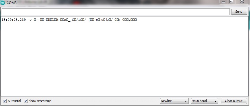

Hi, Im currently working on waterflow module using ESP32. But after uploading the code, the output is not what it should be. Please help me find whats wrong. Thank you in advance.
Heres the code and the output

the output:
Why the surprise ?
You do;
And the baud rate in the serial monitor is ?
Screenshot - 01_04_2023 , 09_27_15
So what are you expecting it to be?
What is SENSOR?
Please show a wiring diagram or schematic.
im such fool :") thank you for the reply <3
Im expecting the serial print to show on the serial monitor, but i didnt change the baund rate in the serial monitor :slight_smile:
