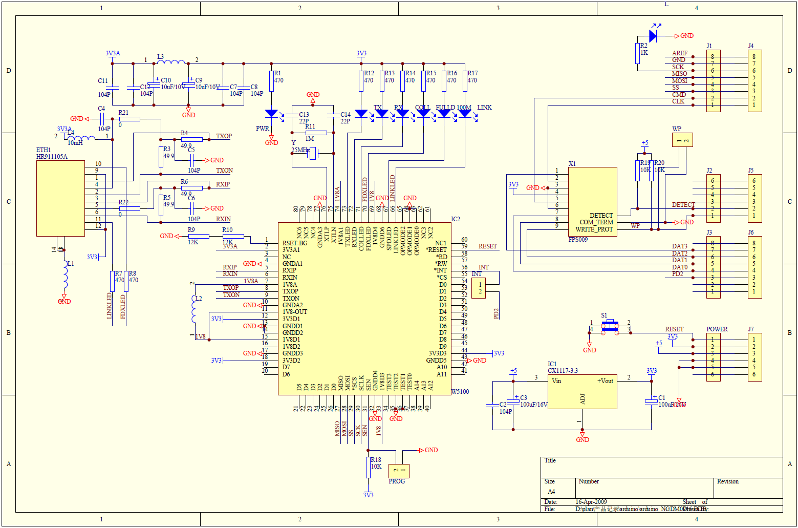

However, that is not a Arduino ethernet shield. It is from DFRobot. I found a schematic, but it is not like the Arduino model.
http://www.dfrobot.com/wiki/images/5/52/Ethernet_shield_SCH.png
I'm not sure what difference is in the circuit boards.

That diagram is correct. That is exactly how it should work.
If that were my ethernet shield, I would perform a simple test to see if the w5100 is releasing the MISO line. That would be the only situation where that would cause a failure of the SPI bus.

Check D13 (SCK) the same way. Since you are not connecting anything to D2 (maybe w5100 INT), I can't think of anything else that would cause that fail, but that would be with an Arduino ethernet shield. I rechecked that schematic, and if it the the correct shield, there should be no problem.
At this point, I would check all Arduino pins that connect to the nRF905 the same way, just to insure none of those pins are "stuck" by the ethernet shield. D3, D4, D5, D7, D8, D9.
