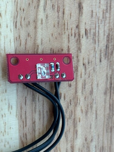

So, I bought an old robot that is based on a 1/10 RC car. It has optical encoders - in total, there are 5: 4 for each wheel and 1 for the motor. I would like to connect them to an Arduino somehow, but I have no idea where to start. The original proprietary controller, which the robot would have had from the factory, didn’t come with it. Any help is greatly appreciated

From the pictures, each sensor has a GND, VCC, CHA and CHB. So, without much effort, I deduce that you might connect GND to the Arduino GND, VCC to the Arduino +5V, and CHA and CHB to, for example, pins 2 and 3, then write a small program to, maybe, output the state of CHA and CHB to Serial Monitor, then try to cause the inputs to change state.
I'd hook one up to begin with, since they're all identical.

Two years ago, I used a basic code to connect it to my Uno, but I never got consistent results. It would be very sporadic, jumping from single digits to triple digits. So, it was shelved until now, when I will have some more time to dedicate to the project.
Just noted the "ENC-100" designator in the part number. Makes me think it's actually some form of encoder providing a quadrature signal based (perhaps) on some surface irregularity on the wheels of the device. That would make me think that you might not get any useful signal, unless the sensor were pointed at (gasp) a surface with that irregularity. So not a surprise you got nothing worthwile.
The encoder wheel is perfectly flat and the distance from the sensor doesn't change since it is all bolted together. But even then those numbers would be all over the place.
What "numbers"? Did you use a code capable of capturing quadrature encoder signals? If you look at CHA and CHB with an oscilloscope as the wheel is turning, you'll see two square waves, 90 degrees out of phase. There seems to be much you're not telling us about prior testing, etc. Why is that?
Because you haven’t asked, how can I tell you about something you haven’t asked about? Other than just saying I’ve done simple testing before. Why are you assuming something is intentionally being hidden?

I will guess those photos are of transceivers. The two dots in the plastic are TX and RX, probably IR. Anything very close, with encoded knockouts, moving past will cause a pulse. Perhaps CHA is TX and CHB is RX, or the reverse.
Hi, @PicoSavvy
Can you please post some pictures of what the sensors were looking at?
The wheel or marker on the wheel, what surface were they detecting?
Do you have a DMM? (Digital MultiMeter)
