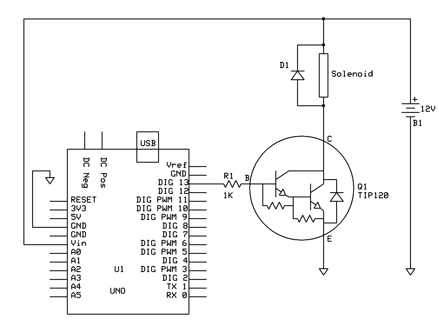

circuit is on attachment sir :slight_smile:
Ok, I see it now.
First of all, the schematic shows RX of the HC-05 going to the Arduino RX, which is wrong. RX goes to TX and vice versa.
Secondly, it shows the 12V going to the 5V pin, which will certainly try something. You need to connect it to VIN, not VCC.
All you need to do to control the solenoid via a transistor is set the pin to high or low (depending on the type of traffic being used). Pretty simple.
I get it now, Sorry for the circuit , my fault.
But now I understand how to set the pin 13 only to high and low ??
Can i delete those other pins??? i just need pin 13 to control the solenoid right?
Yes you only need pin 13. You can delete the others.
Pin 13 is connected to an onboard LED that flashes during bootup.
Your door lock could rattle/unlock during bootup if you use that pin.
Better use a different pin, e.g. pin 12.
The solenoid is connected between +12volt and the base of the TIP120.
Should be between +12volt and collector.
R1 goes to the base.
The BT module needs a level shifter on it's RX pin if you want it to last.
It's a 3.3volt device (powered by 5volt).
Pins 0 and 1 are also used by the USB<>Serial chip.
Maybe better to use SoftwareSerial on two different pins.
Leo..
Q1 is completely wrong in your circuit. Copy the correct way from: Arduino Playground - HomePage
(except use a 220 ohm base resistor for a 2N2222 or other non-darlington device, 1k for a darlington is fine)
This is what you should have;
NOTE: DO NOT CONNECT 12V to the Vcc or 5V pin of the UNO, you need to connect it to the Vin pin.
Check datasheet for pinouts of TIP120.

Hi sir , can i use the 12 pin to control the solenoid? what changes do i need to do?
TomGeorge:
Tom... :slight_smile:
Thanks for the Circuit sir it really a big help :slight_smile:
