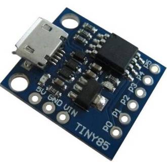

I am using the ATiny85 USB board to make and control functions in a Model Railway(Railroad) dcc system. The basis of this sytem was developed by a guy in the netherlands Ruud Boer and the link to this topic is given here:

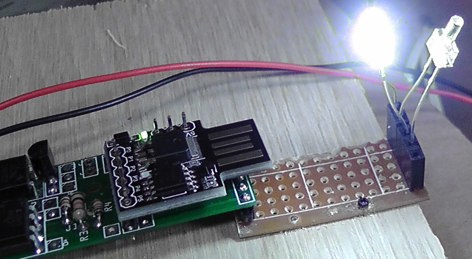

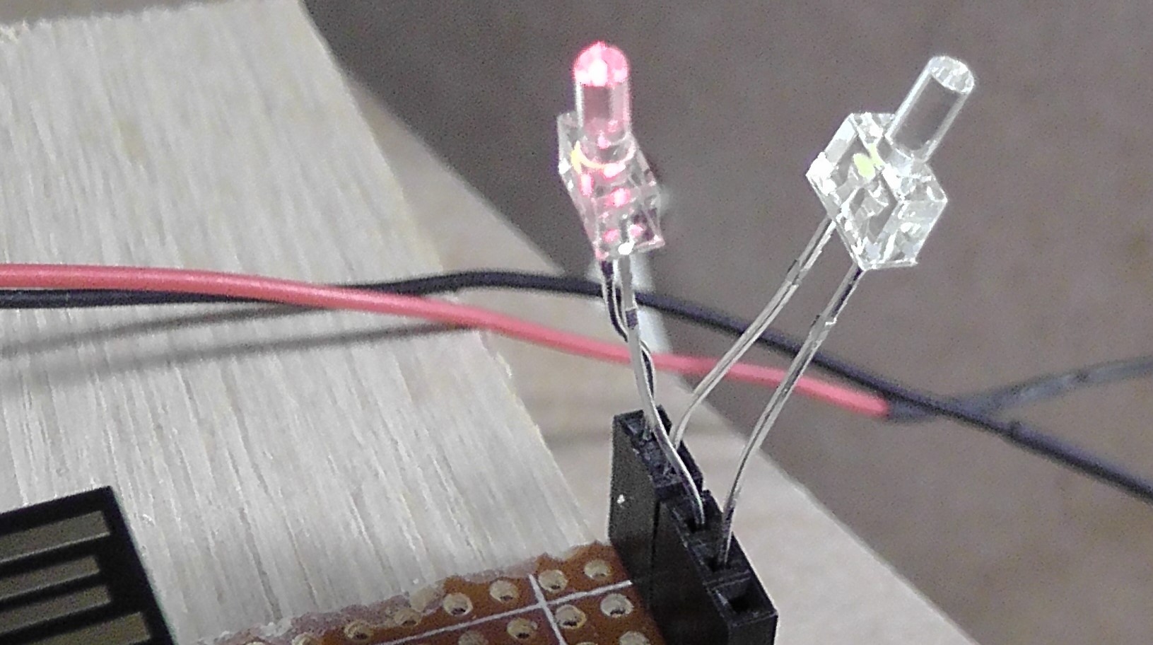

How it then works is that I hook the ATTiny through a circuit board which supplies 5v to the ATTiny85 and the dcc signal from the track through an optocoupler circuit. As illustrated in the picture. When F9 is activated the LED goes red but with no real brightness when F10 is activated then the white light is as expected. The same is true for the f11 and F12 functions. If I reverse the polarity of the leds then the red is bright and the white dim. It would appear that the problem is in the code not the circuit. Clearly I should have much the same brightness in both conditions.

What is causing the led to be dim. In the F9 condition activated i.e Pin 0 HIGH and Pin 3 LOW and also in the F11 condition Pin 1 HIGH and Pin 4 LOW the leds are dim and the measured volatge is about 1v not 5v. It worksin the simple code why not in the more complex code scenario.
