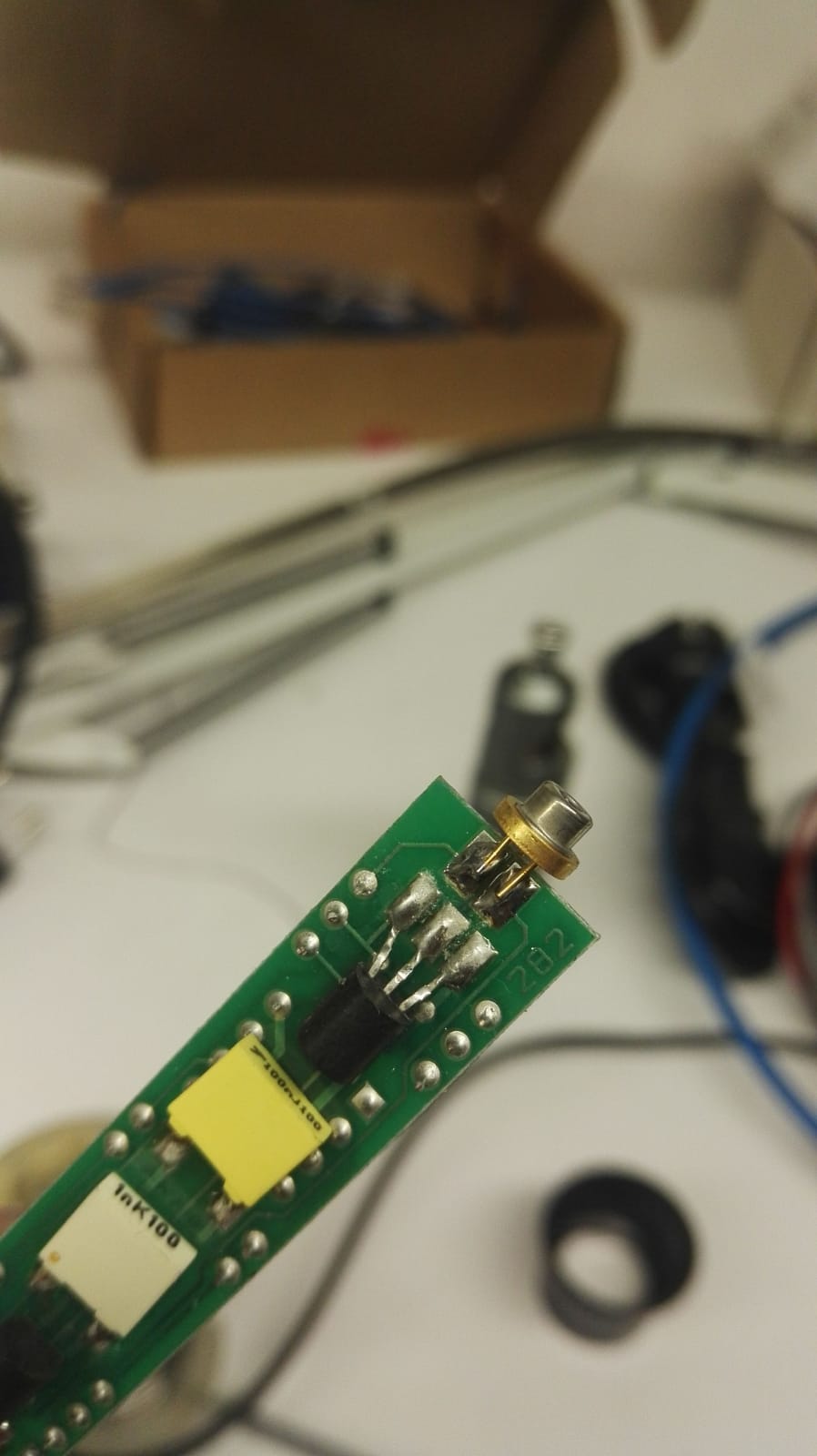

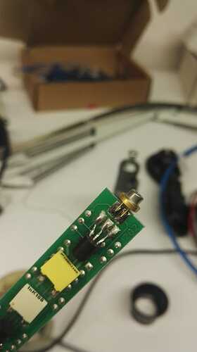

I need to change a laser diode but all that is written on it is Q 8C on the bottom (nothing on the side) (picture attached)
anyone have any idea on how to find a suitable replacement?

No idea, but it might help if you tell us exactly what device it comes from and maybe post good pictures of the front and the back of the PCB as well.

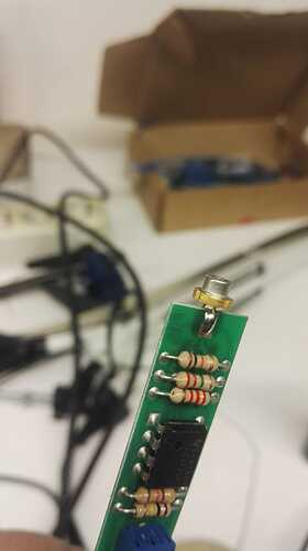

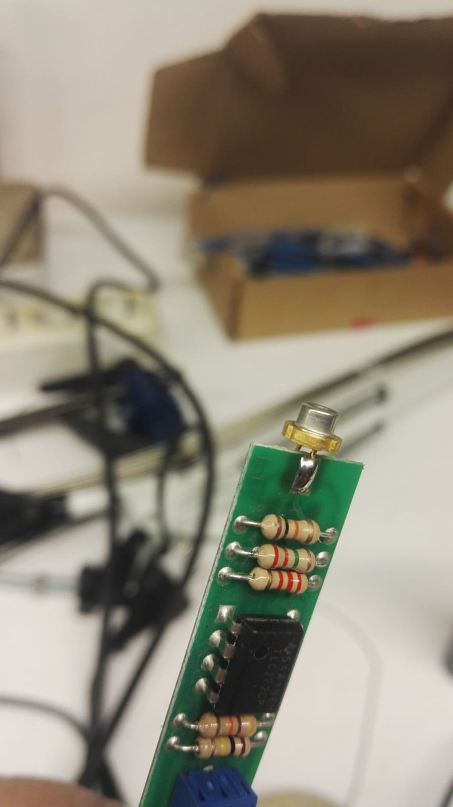

Here are more pictures... it is a temperature sensor
No more information? The markings on that 8 pin chip would be useful, bit too dark in those photos.
Reverse-engineering the circuit might show how the laser is being driven (constant current usually)
and might show what current value is involved, enabling choice of a compatible laser diode.
Current level is critical for laser diodes, too much and they pop, too little and they will fail to lase

No, the laser diode is used as a sensor itself. ( I suppose measuring the feedback pin when the laser diode is NOT powered on ) and also as a pointer that you activate only when you need to aim the sensor. It is used to measure temperature on metal during welding (between 600 and 700 C) and there are NO other components in there so the only way I can see that working is that the photodiode inside the laser diode package is used as a sensor. That is why I need to get the exact part, in order to be sure that the output is the same.
The two IC are both TLC272CP which are operational amplifiers, that are probably used to amplify the feedback pin signal to a level that is usable to the machine controller.
