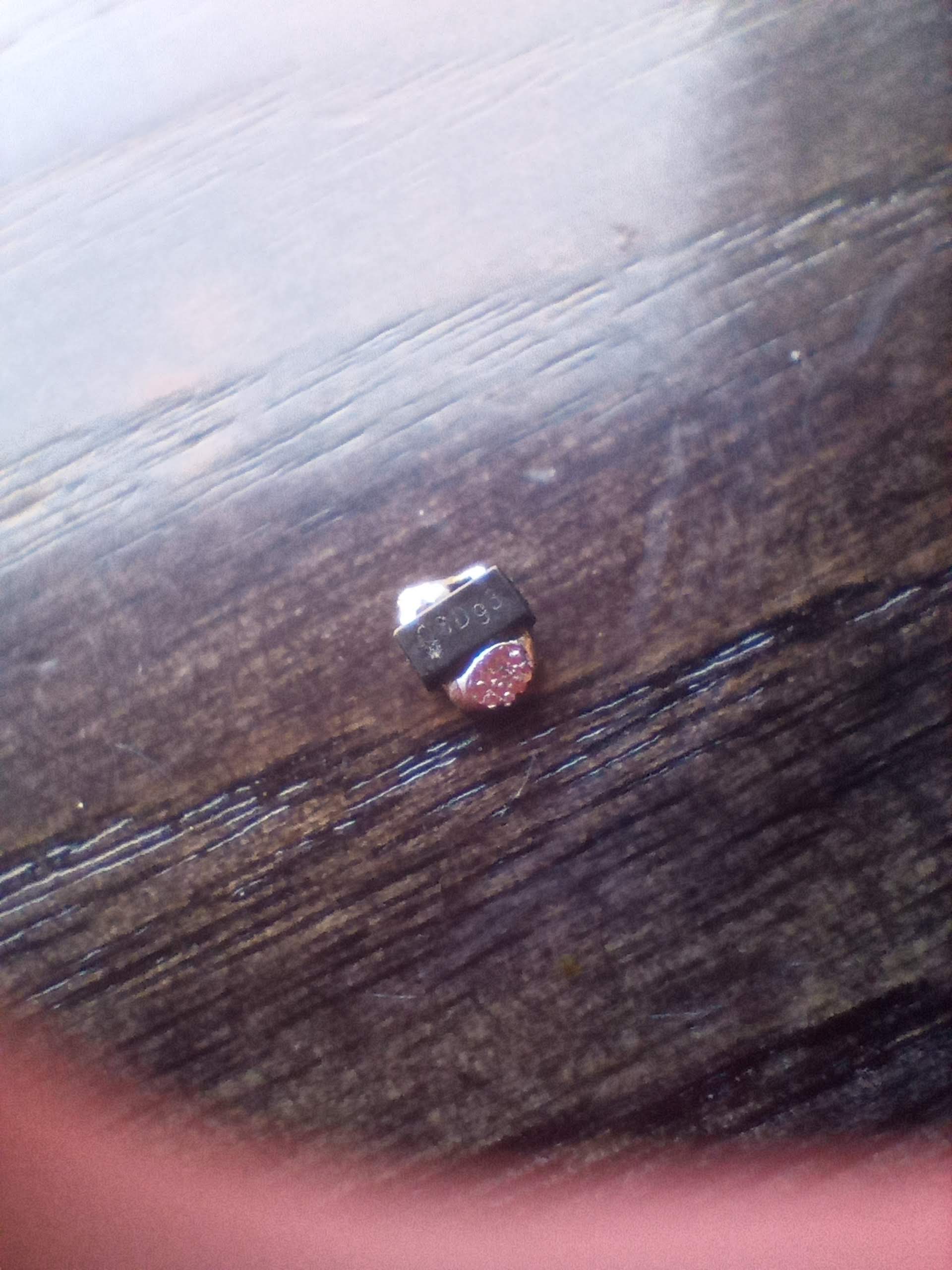

wonder if anybody recognises this ic, pretty sure its a lithium battery charger ic ive tryed every letter combination that looks close to it, maby someone recognises it, i can make out D93, but first two characters i cant first character looks like 0?.

You will have to attach an image of the IC for us to tell if it is familiar.

Zooming in does not help as much as I thought it would.
C or 0 for first
8 or 9 for second
3,4,5 are easy D93

Smaller IC's usually have date or factory codes on the package, not part numbers. Your only hope is to spot another one somewhere, in a circuit that you have the schematic for.
It appears to be a BCV61B. This is essentially 2xBC547B NPN transistors in 1 package.
http://www.smdmark.com/en-US/ic-299184.html
