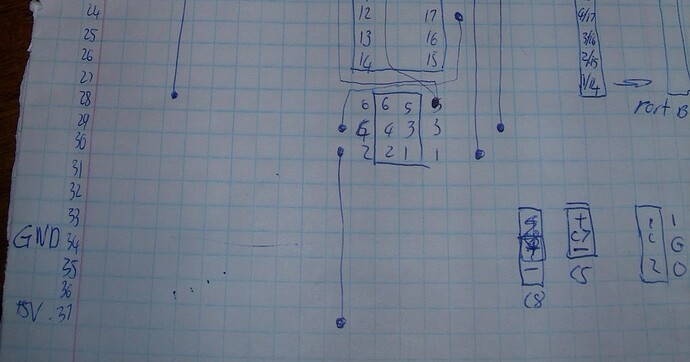

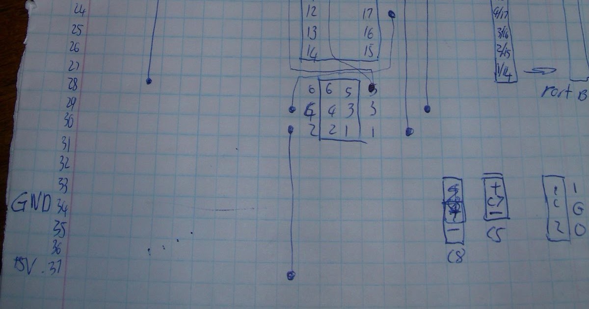

i have made my own arduino serial, using this as a guide, arduino.cc/en/uploads/Main/ArduinoSeverinoManual.pdf
i did the board on stripper board (vero board) i will upload a picture of both sides of the board and my "design" when i get home from work.

here is my arduino on vero board, ill be very happy if it works... just really wish i could get pcb's where i live...
