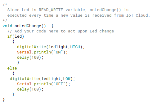

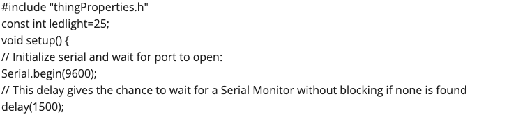

Help me find the solution. The code is correct, and the Switch settings on the dashboard are properly configured, but I still can't control the light
#include "thingProperties.h"
const int ledlight=25;
// Initialize serial and wait for port to open:
// This delay gives the chance to wait for a Serial Monitor without blocking if none is found
delay(1500);
pinMode(ledlight,OUTPUT);
// Defined in thingProperties.h
initProperties();
// Connect to Arduino IoT Cloud
ArduinoCloud.begin(ArduinoIoTPreferredConnection);
The following function allows you to obtain more information
related to the state of network and IoT Cloud connection and errors
the higher number the more granular information you’ll get.
The default is 0 (only errors).
Maximum is 4
setDebugMessageLevel(2);
ArduinoCloud.printDebugInfo();
ArduinoCloud.update();
// Your code here
Since Led is READ_WRITE variable, onLedChange() is
executed every time a new value is received from IoT Cloud.
void onLedChange() {
// Add your code here to act upon Led change
if(led)
digitalWrite(ledlight,HIGH);
Serial.println("ON");
digitalWrite(ledlight,LOW);
Serial.println("OFF");
What is triggering onLedChange() in your code?
What is calling that function?
"The Arduino IoT Cloud is calling the onLedChange() function automatically whenever the associated variable (led) changes its value."

Please do not post pictures of code
Please post your sketch, using code tags when you do
Posting your code using code tags prevents parts of it being interpreted as HTML coding and makes it easier to copy for examination

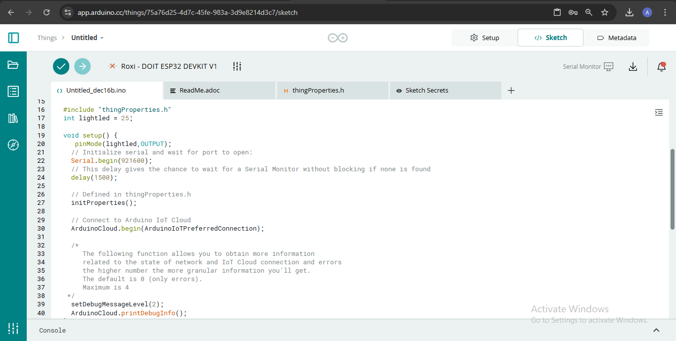

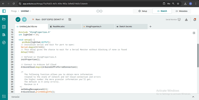

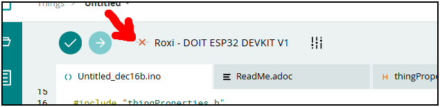

I see that at the time you took those screenshots there was no connection to your ESP32 board:
The upload capability is disabled when there is no connection:

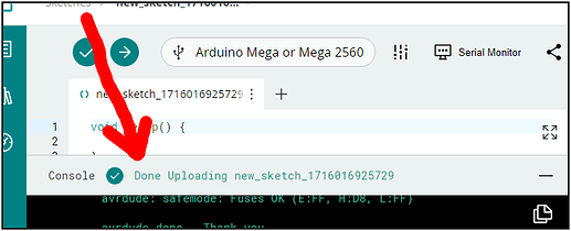

@abderraouf_ben have you successfully uploaded your sketch from Arduino Cloud Editor to the board? This is done by clicking the rightward pointing arrow button on the Cloud Editor toolbar, then waiting until you see a "Done Uploading ..." message on the status bar:
If you never uploaded the sketch to the board, then this would explain the problems you have reported here.
