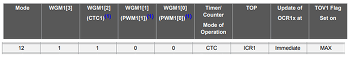

In which Mode -- 4 or 12?
OP may exercise the following sketch of Mode-12 (CTC) and the setup (Fig-1) to see if duty cycle could be varied by changing the value of OCR1A.

Figure-1:

in all modes where TOP value is set by OCR1A or ICR1
The duty will always 50% because the state of the pin will be TOOGLED once on the period - from HIGH to LOW in first cycle and than from LOW to HIGH in the next cycle.
So the duration between the toogles will be always equal to full timer cycle and freq of signal will be half of timer freq independent from OCR1A value.

Then I am confused to interpret the meaning of "Update of OCR1x at" of Fig-1 in Mode-12 (CTC). When ICR1 sets the frequency, then what is the use of OCR1A Register.
Figure-1:

OCR1A and (if applicable) OCR1B controls the phase of the generated signals
Interesting! I will do the experiment. Which one is to be taken as reference -- OC1A or OC1B?
There is no predefined "referemce point". The phase is relative one from the other.
Take the test, you will see.
