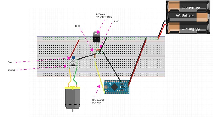

Hey everyone! Thanks to the great help I received on this forum, I obtained all of the components I needed for my project and I now have a working prototype on my breadboard.
I'm developping a very simple circuit that controls a DC motor, slowing it down to about 33RPM using an Arduino Pro Mini and a MOSFET motor driver.
Although my breadboard prototypes work, I have to admit I feel like I wired it wrong. I watched tutorials and based myself off of others breadboards that I found online, but the whole thing still seems... fishy.
I would like for someone to quickly review my wiring and tell me if I'm missing anything. Sorry for the terrible Fritzing diagram, I struggled to do something clean on the software.
This is what I'm trying to reproduce:
And this is the current state of my breadboard. I'm not yet using 3 AA battery to power the Arduino, but instead using the USB to SATA adapter to give 3.3V to the Arduino VCC pin, then using the VCC & GND pin to power my breadboard. My motor is spinning correctly, and the code I have is working successfully. (Nevermind the weird battery compartment. I couldn't find a 3 AA battery on Fritzing so I photoshop it instead.)
Any help would be greatly appreciated!
motor power input not shown
180 Ohm resistor wrong wired
Your 10K resistors aren't wired up right.
Don't run motor currents through breadboards. The contacts aren't designed for such currents and will get damaged.

Good job on the photo shop. With your skill I would consider learning CAD (Computer Aided Design) software for electronics such as KiCad, it is free as are many other packages. Schematics is the written language of electronics.
Never run power through pin boards they will not survive. Also running motor power through your Arduino is a big No No.
I am not sure about your MOSFET, you did a great job with the pull down resistor but without knowing the MOSFET parameters I cannot determine if it is adequate for the job. You need to look at the Vgs curve to check if it will conduct the current at the supplied gate voltage. Many designs on the web show the pulldown resistor at the gate of the MOSFET with a another resistor to the port pin, this is a bad design as the resistors form a voltage divider lowering the Vgs voltage. You did it correctly as the pull down resistor will keep the mosfet off during reset etc until the processor gets control.
Whenever possible get an avalanche rated MOSFET, that eliminates the flyback diode requirement. If you use one anyway it will not hurt anything but the MOSFET will conduct before the diode. The diode needs to be sized for the motor current. Many use the 1A devices and at larger loads they will eventually fry.
You can connect the motor at the battery instead of the Arduino.
The IRFZ44 is not a logic level MOSFET, and will not work well or at all with a 3.3V Arduino.
As pointed out, the resistors are not correctly positioned.

Don’t use IRFZ44, use IRLZ44
See these Logic level MOSFETs.
Run the battery power to the breadboard, not thru the Arduino
Your 10k and 180R resistors are shown in parallel, these are not wired as per the schematic.
Here's my attempt at correcting my circuit based on your feedbacks. Thanks!
1.5v X 3 = 4.5v
4.5v is a bit low for a 5v Arduino.
Note, your resistors are still not wired correctly, compare what you have to this circuit:
Not a major problem, the 10k resistor should go to the breadboard GND, not the Arduino GND.

Then the Battery 4.5v should go to Arduino RAW if that’s the way you it’s going to be powered.
Confirm with a voltmeter, the Arduino 3v3 pin is reading 3v3.
The Mini is not plugged into the Breadboard as it is designed to.
