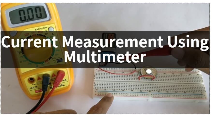

Measure the current drawn from the AA batteries by the power supply and tell us what you get.

We need to know the current in mA drawn by the power supply from the 2xAA batteries.
If you have a multimeter, put it on the current scale (somewhere around 200 mA could be a place to start), and place the meter leads in series with one battery connection to the power supply. Observe polarity!

The batteries are rechargable. I wasn't able to get a current reading for some reason but the device is operating.
You need to connect the multimeter in-line with the power ("series") rather than across the terminals ("parallel")
Have a quick read here:
(Edit: I'll admit that was maybe not the best resource. Big diagrams though..)
