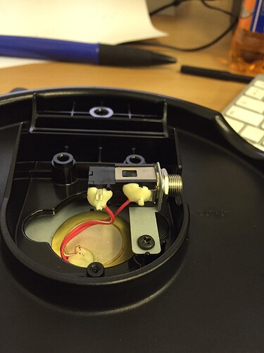

this is the inside of the drum pad being used on my version
just incase there is an easy option you can see with this and the strip lights
cheers adam
Thanks for the photos. That's funny, those are the piezo discs !
I can't see any electronics, so the piezo is at the connector and nothing else. You might be able to connect that to the MIDI device as well as to the Arduino. Or just straight to the Arduino.
I can't find a schematic right now, but for the final version you could use some protection. A resistor parallel to the piezo, a diode to 5V for too high voltages, and a protection resistor to the Arduino input.

the 1/4 inch jack runs the pad back to the drum module
If it is no problem that the ground of the Arduino is connected to the drum module ground, then you could use the same signal to the Arduino and to the drum module.
You can start by using it to the Arduino only and see if you can use it as a trigger. The piezo disc won't be damaged when you accidently apply 5V to it.
