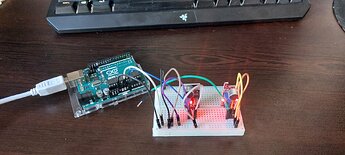

Hello everyone, I'm am currently trying to make a acoustic guitar tuner as a project and I am running into some problems. Currently using a Arduino Uno, swapping between two sound sensors to check if there is any difference and a lCD display with I2C which i will remove for simplicity for now. These are my sound sensors:first one is and second one.
My problem is that when i struck any of the string the frequencies are either way higher than the ones that should be either because of the mic quality or environmental noises (or both).

You didn't answer, "Where do you position the sensor when you tune?". Looking at your photo, are you just picking up the sound in the room?
The photo does not really allow me to see how the wires are connected. Please post a wiring diagram, use pen and paper and label all connections.

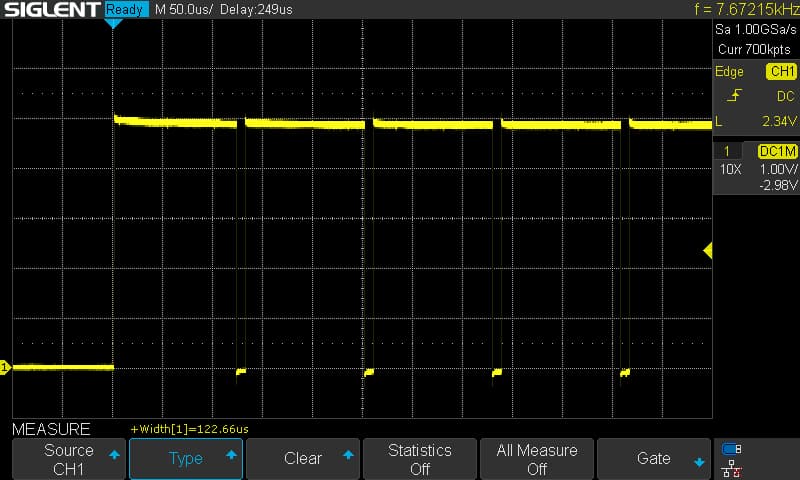

I didn't think that an Arduino Uno could do analogRead(0), and take samples at 22050 per second.
So i added two lines to your sampling routine, so that I could use an oscilloscope to measure how long the analogRead(0) takes.
PORTB = B00010000; takes pin D12 high (in 62.5ns - faster than using digitalWrite(12,HIGH);).
PORTB = B00000000; takes pin D12 low again.
(Plus added pinMode(12, OUTPUT); to setup).

And here are the results:
It is taking 123μs to do the analogRead.
By setting the sampling rate to 22050, you are expecting the analogRead(0) to take less than 45μs, which it can't do.

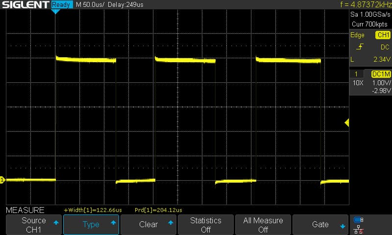

I changed the sampling rate to 5000, which the Uno can do.
The results were a lot closer to being correct.
Using a 440Hz sinewave signal from a function generator, I got the following results:
I think that the error is now due to the fact that the timing is incorrect as the line
 for (int i = 0; i < SAMPLES; i++) {
is outside the timing loop and takes a few extra microseconds.
For Sampling frequency of 5000, the period should be 200μs, but i measure it as 204.12μs
