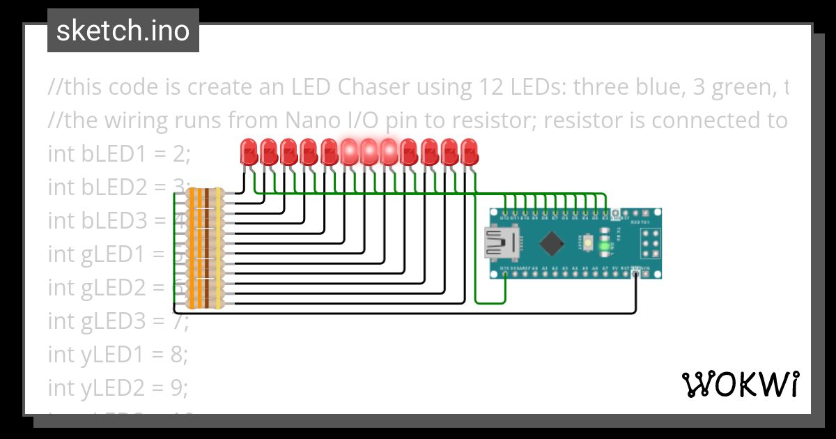

Help Needed on Quick Flash happening during LED chase sequence
I'm relatively new to Arduino, but I've created a chase sequence using 12 LEDs. I'm trying to use custom functions to learn about how they work. The code compiles fine and downloads to my Arduino Nano. The intent is for the LED chase to start slow and increase in speed until all LEDs stay lit before turning off and resetting for the next chase sequence. The trouble is that I have a "blip" or a "flash" happening on all LEDs just before the first LED lights in the chase sequence. I can't for the life of me explain why this is happening. Can someone please look at the code to see what I might be doing wrong? I've tried commenting the code to help show my intention. Thanks in advance for any help you may offer.

I have not looked at your code in detail but the first thing that I would urge you to do is to learn to read about and use arrays. Your code could be reduced by at least 50%, probably more, and this would make it easier to debug and maintain

Increase the resistance of the current limiting resistors you are using. Even the simulator sees the immediate draw of current, biasing the LEDs to "flash". Compare these two simulations...
Simulator is remembering values from previous sketch. After loading the simulation, F5/refresh your browser to remove artifacts from previous sketch.
Flash (300 ohm resistors)
No flash (300k ohm resistors)
Thanks, I'll take some time to figure out arrays and how to use them.
The wokwi site is pretty amazing. Had no idea that it existed. I'll try swapping out the resistors. I'm currently using 220 ohm resistors so I'll go for something bigger and see what happens. Plenty of things for me to unpack and learn about how you coded a chase sequence.
The simulator seems to "flash" all the time now.
I tried setting all the anode pinMode() to INPUT in setup(), then set the pins LOW before setting the pinMode() to OUTPUT... but still the flash... I hope the realworld project goes better.
In the WOKWI, try adding the highlighted line:
All, UPDATE: I tried changing out the resistors, but the flash persisted. I then took the advice to learn and use arrays and reworked the code. As it turns out, I solved the flash issue in the redo. I'll copy the solution I came up with below. Thanks to everyone for all the help and support.
