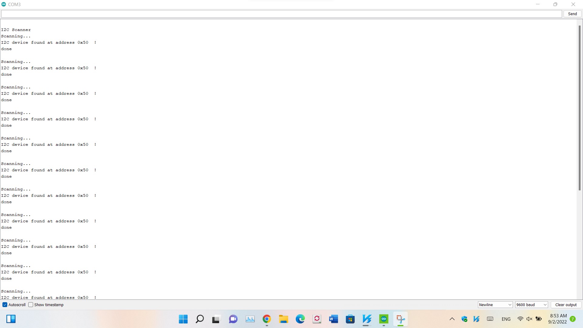

I ran the I2C scanner, and it said the address is 0x50 (so I was wrong about it being 74). A0 is connected to the ground.
I2C scanner showed this.

When I use I2C scanner, I got 0x50 as the address. However, this is different from any of the device addresses I see on the datasheet. Do you know why this is happening?
Hmm.
With AO tied to AGND, The three address bits will be 0. Therefore, your address is, per page 24, 01001000, or 48 hex; not sure why you're getting 50, that would imply, possibly, bit3 is appearing as bit4, but it may have something to do with that funky tying of the A0 pin to various active signals.
Based on that, I'd try talking to address 48h. If that works, we may have a case where the device address isn't getting properly read back in the i2c scan code, which would be troubling - but if so, it's more likely an i2c timing violation by your e-pot, rather than an Arduino code issue.
