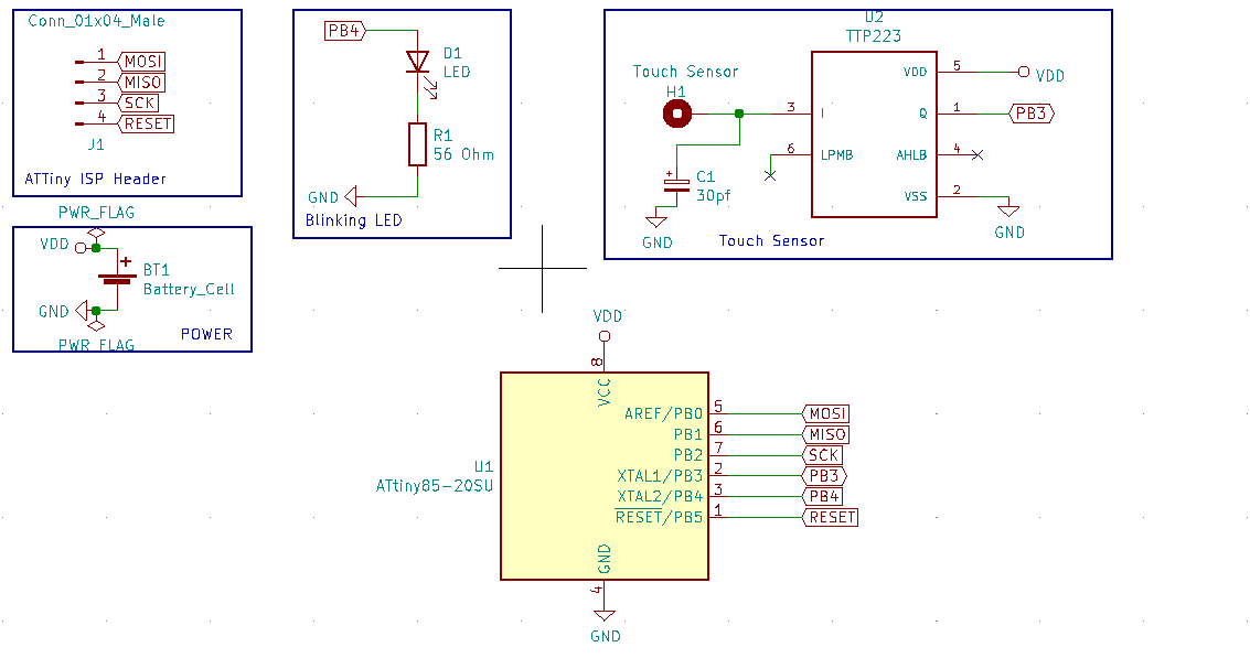

My circuit is very simple and consists of an attiny13 connected to an LED and a TTP223 which acts as a touch sensor on my board. Schematics below:

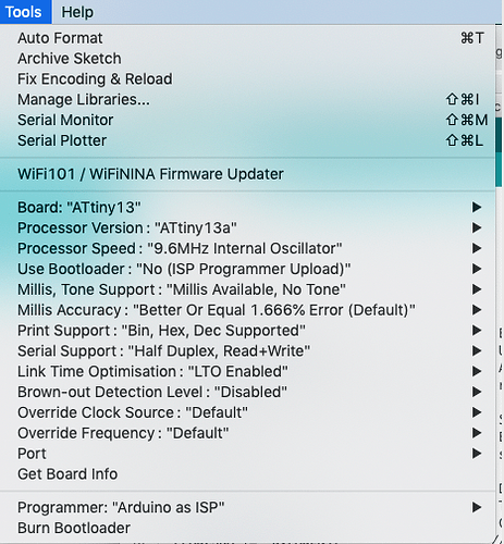

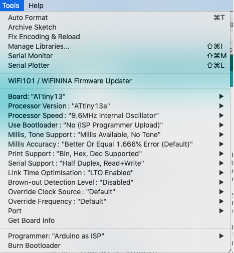

I do, however, have one board I programmed a few months ago that work correctly with any batteries I put on it. And this is using all the same hardware. I'm pretty sure I used the same code but can't be so sure about which options I used on the Arduino IDE when programming it. This is what I have now, and I tried using different Brownout detection level options.

Please post a hand drawn circuit diagram, with pins and parts properly labeled, plus links to sensor modules.
Image links are broken. Post them in line, following this guide.

My apologies. Images uploaded now
Your schematic does not show the required bypass capacitor across the MCU power terminals. Minimum value 100 nF. An additional 10 - 100 uF cap in parallel will also help.
If the Brown Out Detector is enabled, how did you set the fuses?

Your schematic does not show the required bypass capacitor across the MCU power terminals. Minimum value 100 nF. A 10 - 100 uF cap will also help.
I don't have that. I'll add it in and report back. But I also don't have that on the board I mentioned works well. Can you please point to me to any documentation on that?
I didn't. Sorry, I'm new to this. I just selected the option in the Arduino IDE
You need bypass capacitors in just about any circuit, but especially ones with a complex IC. Sometimes circuits will work without one, but it is really a bad idea to count on that. Google "bypass capacitor" or "decoupling capacitor" for 11,400,000 discussions.
For typical documentation, consult the TTP223 data sheet you linked. Note the example circuit diagram, and this comment:
  1. The C1 capacitor must be used between VDD and VSS; and should be routed with very short tracks to the device’s VDD and VSS pins (TTP223-BA6/TTP223N-BA6).
The MCU data sheet documents the Brown Out Detector. It is probably resetting the MCU when the battery voltage drops, as a result of excessive current through the LED.
Increase R1 to at least 470 - 1K Ohms. An efficient LED can be quite bright with just 1 mA current.

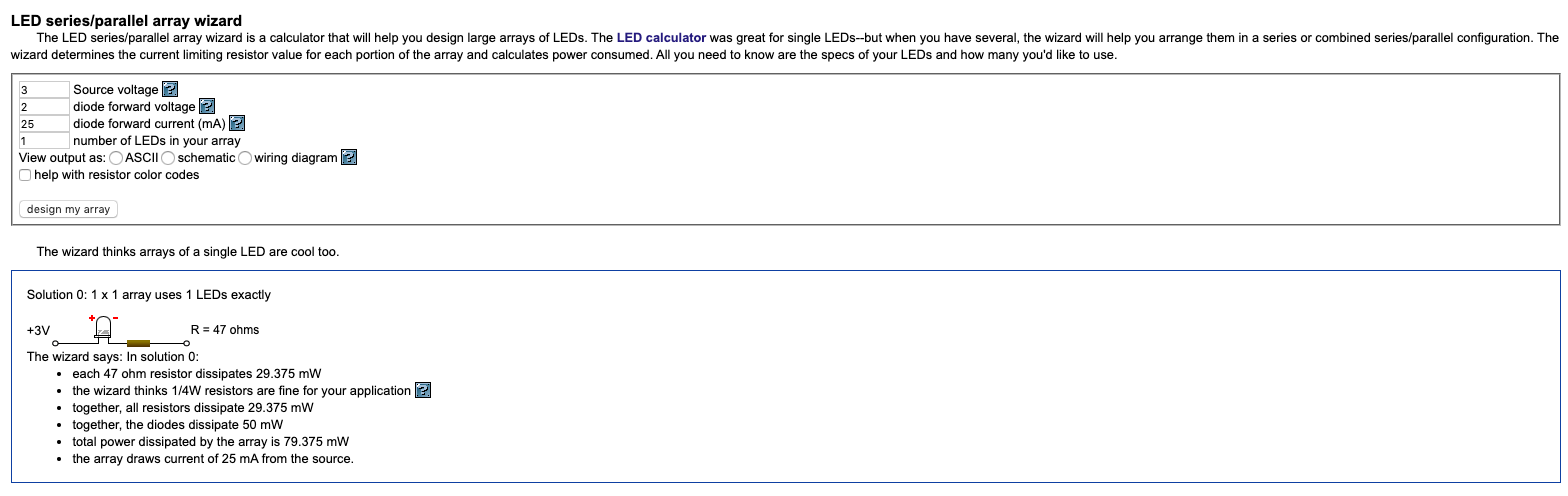

Bingo! That was totally it! I replaced the resistor for a 1K and the circuit is fixed! I've tested this. a million times on a 56 ohm resistor after using the calculator here. Which always gave me this result:
This is the LED I am using!
I guess this is provided I always get a stable 3V, which in my case will not happen as this is battery powered. I feel like I learned a lot here. Thanks :wink:

You still need the decoupling capacitor. It is likely to fail unpredictably without.
