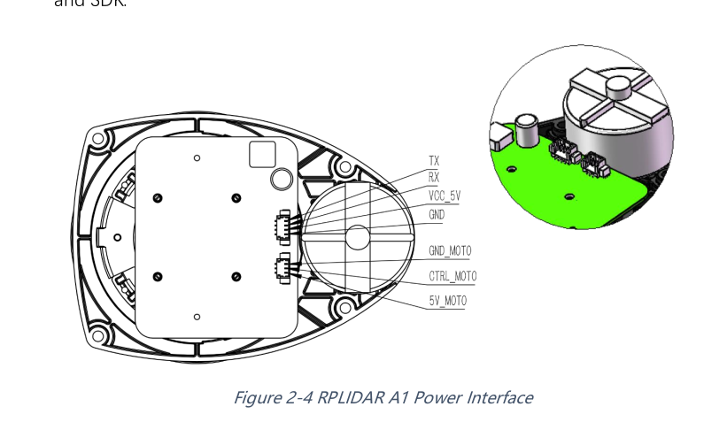

circuit diagram
tx of rplidar to 15th pin of arduino mega
rx of rp lidar to 14th pin of arduino mega
vcc5v and 5v moto - to 5v supply
gnd, gnd moto to gnd supply
ctrl_moto to 3rd pin of arduino mega

Ignore the above suggestion, if you are using Serial3 on the Mega2560.
Double check that you have connected TX on the RPLidar to D15 (RX3) and RX on the RPLidar to D14 (TX3).
fyi, this is the older version of rplidar, I am having new version, actually, for which I have attached the datasheet of it
