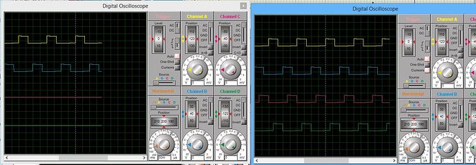

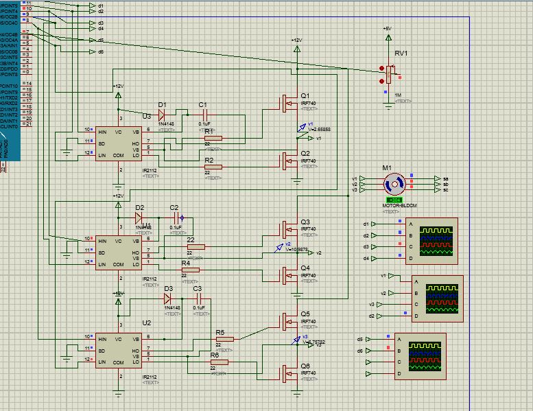

The images of the schematic are attached. The modeled motor is 3 poled. This code should work with it. The issue is, no matter what i do, the motor's speed doesnt change. It should atleast achieve a speed closer to it's rated rpm. It is just stuck at 300 rpm. This is just a model. The hardware works with the motor that i'm using it with.
The algorithm may be faulty, in which case, do suggest a better one.

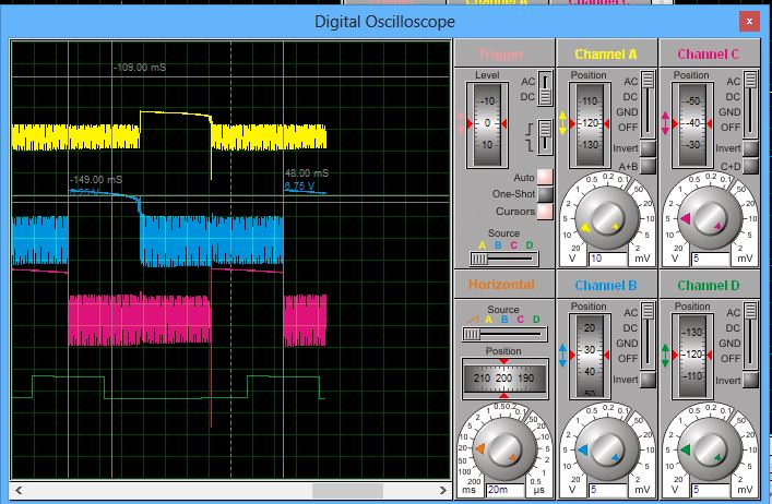

Logically, as the potentiometer value changes, the delay routine should help change the frequency. But it just doesnt work. As soon as the simulation is run, the motor runs up to 300 rpm, and then it's value doesnt change.

I have been able to tell that the drive is given at frequencies of 3.5 to 5 kHz, and the voltage levels measured are around 30 to 36 volts.
