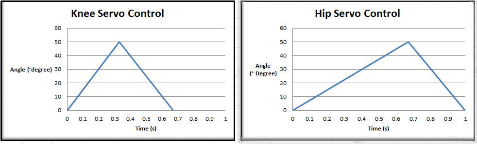

I have written this code and uploaded it
But what is required has been attached in the image, how can i achieve that. kindly help.
i have few days left for submission.

The clue in reply #3 was just a clue - you need to adapt the arithmetic to suit your application.
I have attached all there is, i just can't figure it out. being new to this i managed to learn quite a bit in few days. i have to make it work by tomorrow. i shall be grateful if you can help me with it. the image says all. just one servo needs to make it back earlier.
i can get it straight.
i can't*
sorry.
what if i want the second servo to do it's task earlier than the first servo. how can i implement that.
If you want a part to move faster or to arrive earlier, then maybe use pos+=2 or pos+=3 for that component.
The for loop has been assigned to both the component doing this will give the increment to both the motors, if we look at the code and thus they will move again at the same speed. achieving movement at the same time.
