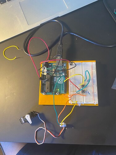

and i tried to remake ur circuit :
When you set the Serial.begin(115200), be sure to also set it in the Serial Monitor, bottom right corner.
As for your wiring, it's best to wire to opposite corners of the button - "diagonal", as this ensures you haven't connected two pins that are internally connected, which will give you a continuous connection, and won't work as a button. You may have chosen the right pins now, but you wouldn't be the first to get it wrong by connecting to the same side, either. Are both green wires which go to the buttons connected to +5? If you can't draw a schematic, and therefore insist on photographs, at least arrange the wiring so we can see, without a doubt, where each wire is going. Many posters on this forum simply walk away from threads where the poster produces pictures like this.
BTW - Could you explain why 115200 is a "little hard for you"? This is puzzling.

okay it works now ! the code is the same as before and the circuit too, i just changed the 115200 , i didnt know what it was.
