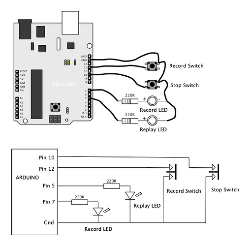

Hi.
First off, I'm rubbish at maths and programming - C++ is a complete mystery to me.
I have built a FootPedal with 4x Momentary Switches and 4x LED's.
This is for controlling ONE channel of a Looper for 3 Musicians (A B C)
The Circuit is here (but it is a MICRO not a UNO board - JPG :
 ![MIDI FOOTSWITCH SCHEMATIC](https://europe1.discourse-cdn.com/arduino/original/4X/0/6/c/06c65609f28773394c24f6ae9f92cb3f296e3cb2.jpeg)
The Sketch, however, is beyond me.
I have studied numerous examples, but they are all very different (libraries, serial, etc.), so very hard to know what is best to do, and most of them won't even compile successfully.
I have started a Sketch with the basics (Pin definitions for Switches and LED's), but I am lost in the MIDI stuff, and getting the PINS\>MIDI and MIDI\>PINS is a mystery.
Could some kind soul take my basic Sketch and complete it please?
Here is the Sketch code with notes for the PIN numbers and MIDI Notes :

> [@the-dub-katsu](#):
Well you don't wire up push buttons like that. It is very easy to get a button rotated by 90 degrees so if you wire them across the diagonal it will always make a circuit through the button when pressed. Also note that you don't need that resistor at all if you enable the internal pull up resistor on each input pin.
The code like you suspect is not good and will not work. Just for starters this bit

RE: Switches - I have seen that some circuit diagrams use a 5v 'third wire', and some don't, just PIN+GND wires. It is easy enough to add in the 5v wire if it needs it. I have tested the contacts in the switches I'll be using, they are definitely momentary.
You don't want to do that at all.
Yes there are quite a lot of bad circuits out there on the net.

There is no need for the two braces { } at the start and end of these definitions. And they should be
```arduino
pinMode(SW1Pin, INPUT_PULLUP);
pinMode(SW2Pin, INPUT_PULLUP);
pinMode(SW3Pin, INPUT_PULLUP);
pinMode(SW4Pin, INPUT_PULLUP);
So they activate an internal pullup resistor. Then you just wire the input pins to ground directly. Then when you read them a push will return a LOW and an un-pushed button will read as a HIGH.
This is the proper way of reading push buttons, any other way is rubbish, and shows the designer of the circuit hasn't got a clue about what they are doing.
In fact the variable 'val' is not used in the code in any meaningful way so it is a waste of time defining them. The code is indeed a pile of rubbish, full of unnecessary braces { } and devoid of any if statements that would make it work. Are those doubts commented in the code yours or those of the original author?
This is how you should wire up push buttons
 ![Fig 4-8](https://europe1.discourse-cdn.com/arduino/original/4X/3/8/c/38cfd7ffc0b3ececeb275bf3a71d38ca7e5459f8.png)
