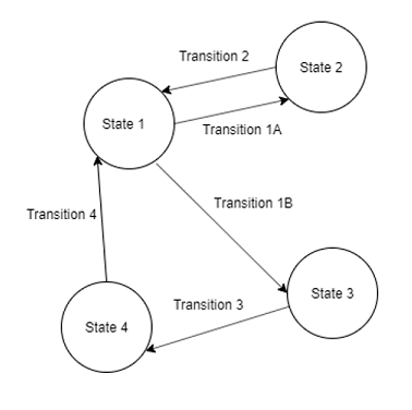

That sort of process which you were modelling, in this case the specific example of a car seat belt alarm, is a classic candidate for a finite state machine solution. You identify the states then the conditions for transition from one state to another and any actions to take on those transitions. Usually a good start is to develop a state diagram such as this simple example and annotate it appropriately:
![image](https://europe1.discourse-cdn.com/arduino/original/4X/b/1/f/b1ff8c673d03fc02b9898d80fb5e858c5091b1a6.png)
The code is then, if you use a model similar to the one I posted, more or less a 1:1 representation of the state diagram.
Incidentally, it did take more than a few minutes to code but I was keen to test/improve my own variant a general solution and put it into a simulator. However, the identification of the states from the original description was indeed quick.
In general, for the best learning experience, it is better to code things like that yourself instead of using a standard ready made library. Then you learn how to solve the problem, not how to use a library.
