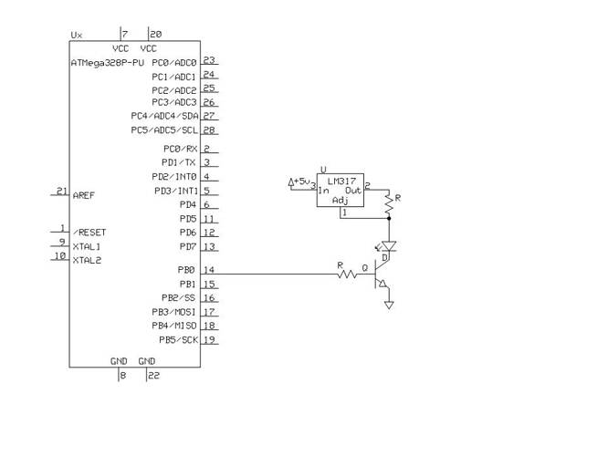

Help to make circuit lm317 and transistor led police lights
Regards to all
can someone help me to make circuit with lm317 and transistor led police lights
i plan to use 1w led 350ma
i have code here

Thanks in advance

What's the LM317 to do? 5V regulator for power to the LEDs?
lm317 as a current limiter
You've got the current limiter part - now put an NPN transistor in series with the LED cathode. A high into the base from arduino will let current from collector (connected to cathode) to emitter (connected to Gnd).
